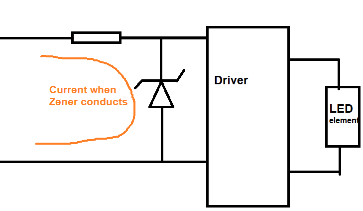

Maybe a voltage limiting Zener diode starts conducting to shunt down the voltage applied to the LED driver module
Yes, that or as I suggested a earlier a linear regulator dissipating the current as heat. I didn't run it on 30v for long, it was cold in my workshop, too cold to hang around waiting to see if the lamp generated lots of waste heat. I just to confirm my suspicions that it was nowhere near the 5w I had ordered it as and see how much the light output varied with voltage, if at all.

Exactly, which it didn't seem to do, so I made a presumption due to the increasing current with voltage, that it was wasting the extra current and voltage as heat - linear regulation, or as Bernard suggested perhaps a series zenor.
In which case - The lower voltage (12v), will be nearer the actual LED wattage. Obviously less than 1w and working at less than 50% overall efficiency at the 30v, due to wastage to heat.
Shunt Zener
When the input exceeds the voltage of the Zener then the current through the resistor increases to drop more voltage
Exactly, which it didn't seem to do, so I made a presumption due to the increasing current with voltage, that it was wasting the extra current and voltage as heat - linear regulation, or as Bernard suggested perhaps a series zenor. .... In which case - The lower voltage (12v), will be nearer the actual LED wattage. Obviously less than 1w and working at less than 50% overall efficiency at the 30v, due to wastage to heat.
Shunt Zener .... When the input exceeds the voltage of the Zener then the current through the resistor increases to drop more voltage
All true as possibilities, but I suspect that, in an application like this, if there were a 'shunt zener' (i.e the usual arrangement for a zener-stabilised supply), I would suspect that it would probably only come into play if the supply voltage exceeded (or, perhaps, 'approached') the 'maximum permissible', since current through the zener 'during normal operation' would result in 'energy wastage' in the series resistor.
