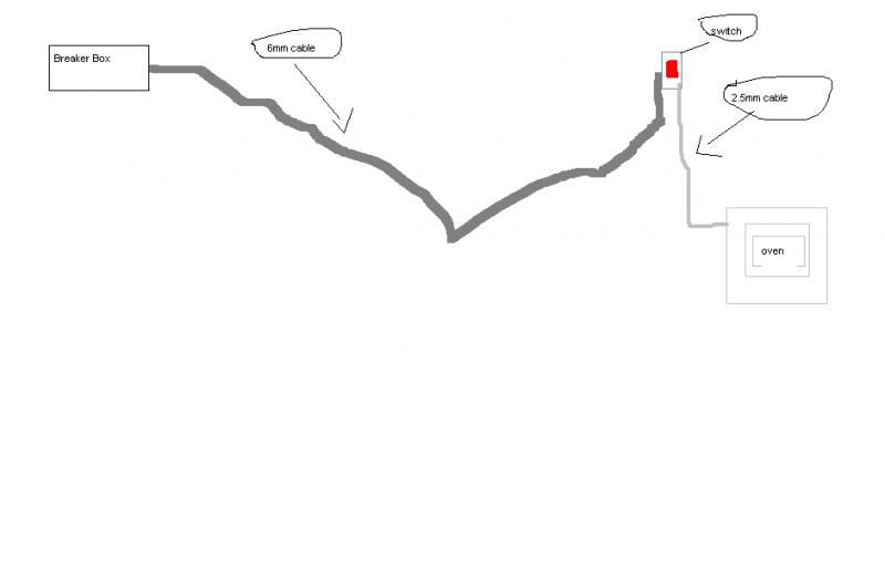

sorry if im confusing the subject, but just to recap,
the cooker has 2.5mm cable comming out of it that will go into the flush outlet plate, but feeding the outlet plate will be 6mm cable from consumer unit via pole switch. Am i missing something?
Whoops, maybe it was me that confused the issue :oops: :oops:.
Your 6mm to 2.5mm set up sounds fine.
Once again sorry.
Ed.
yep you got it does this excellant sketch ring true with your setup ?

Because the cooker is a "fixed" load and it's maximum current draw is less than the max for the cable, the regs do allow the use of a cable with a current carrying capacity less than the protective device.
As long as the cable can handle the fault current it's OK.
