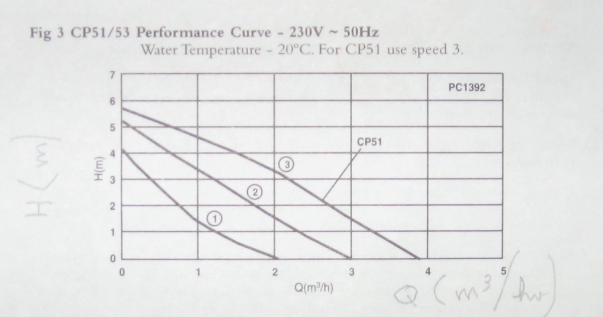

The axis on Performance Curve supplied with the original CP53 are Q(m3/hr) against H(m) but the graph on:-
http://www.pumpsalesdirect.co.uk/media/wysiwyg/datasheets/cp50.pdf
Appears as Q/m3/hr against H/m, so I assume that is a typing error. Note m3=m cubed.
It appears from the graphs that:-
For the CP50: the maximum height on speed setting 1 is 1.2 m
For the CP53: the maximum height on speed setting 1 is over 4 m
Although the maximum flow rates at speed 1, are the about the same when H = 0.
I now post images of the Performance Curves for the two pumps.
I live in a house and the pump is 0.5 m below the maximum height of the radiators, about 2.5 m above the minimum height of the radiators/pipes, and about 2.5 m below the header tank overflow.
Hence using top right CP50 graph, if I buy the CP50, I am right in thinking that I cannot use the min speed setting of 1, and may just get away with the speed setting of 2, ie the middle graph line? EDIT - Consequently, if that is correct then it appears to me the CP50 pump will have a lower life than the CP53 pump !!!
The CP53 graph is taken from the literature supplied with my original Circulating Pumps CP53 pump.
