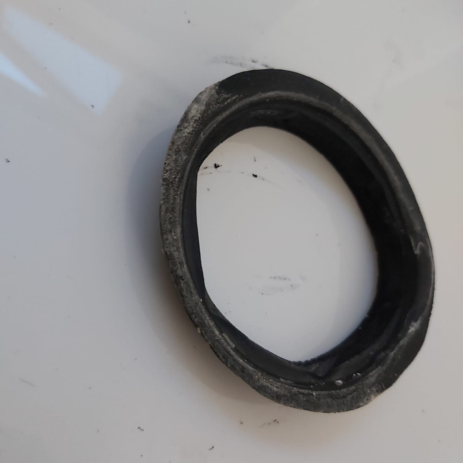

I've got a close coupled toilet. Every time it is flushed, water seeps out from where the cistern connects to the pan. Is this the doughnut washer and why would it suddenly start doing this?
The bolts holding the cistern down are nylon and don't appear to be involved.

Probably, they don't last forever unfortunately.

No sealant (although Plumber's mait is sometimes necessary) but try and match the existing donut as there are quite a few varieties.
UPDATE - replaced the doughnut washer and issue has been fixed. Thanks for your advice and comments. Much appreciated. Here is a pic of the old washer.
