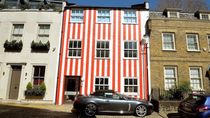

Remember that woman that painted her London house in stripes :ROFLMAO:
When you said this I had to look it up! Nice! :D:LOL:
