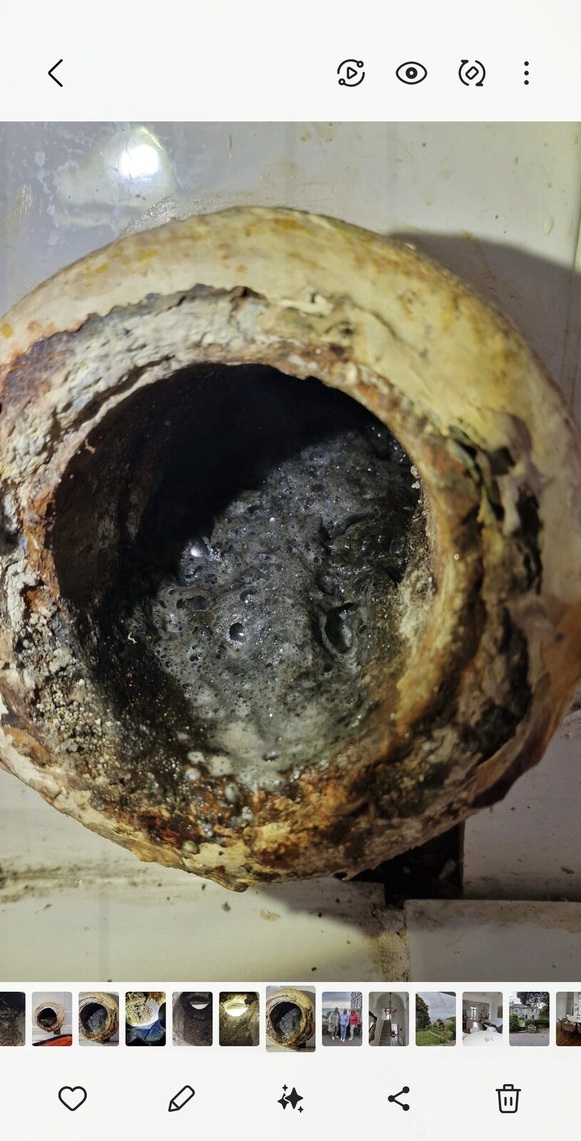

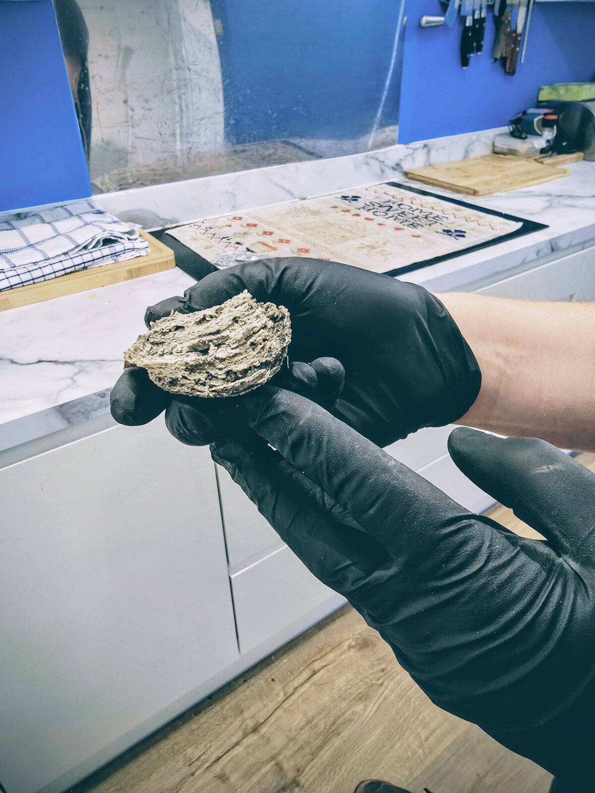

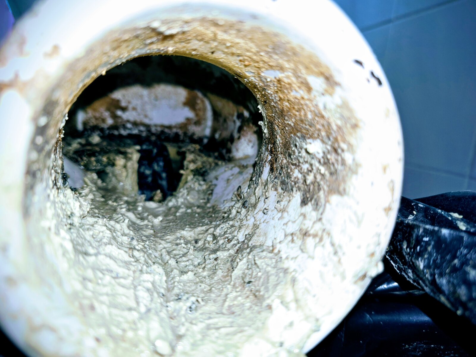

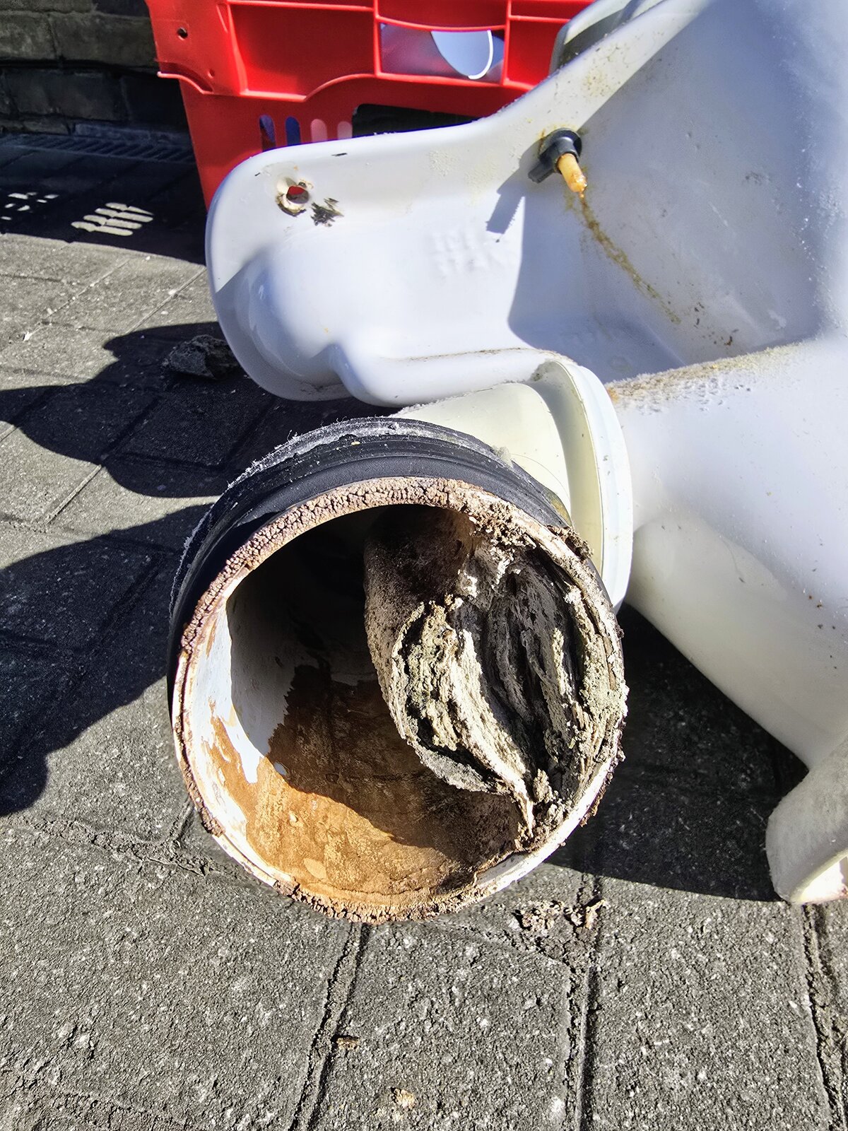

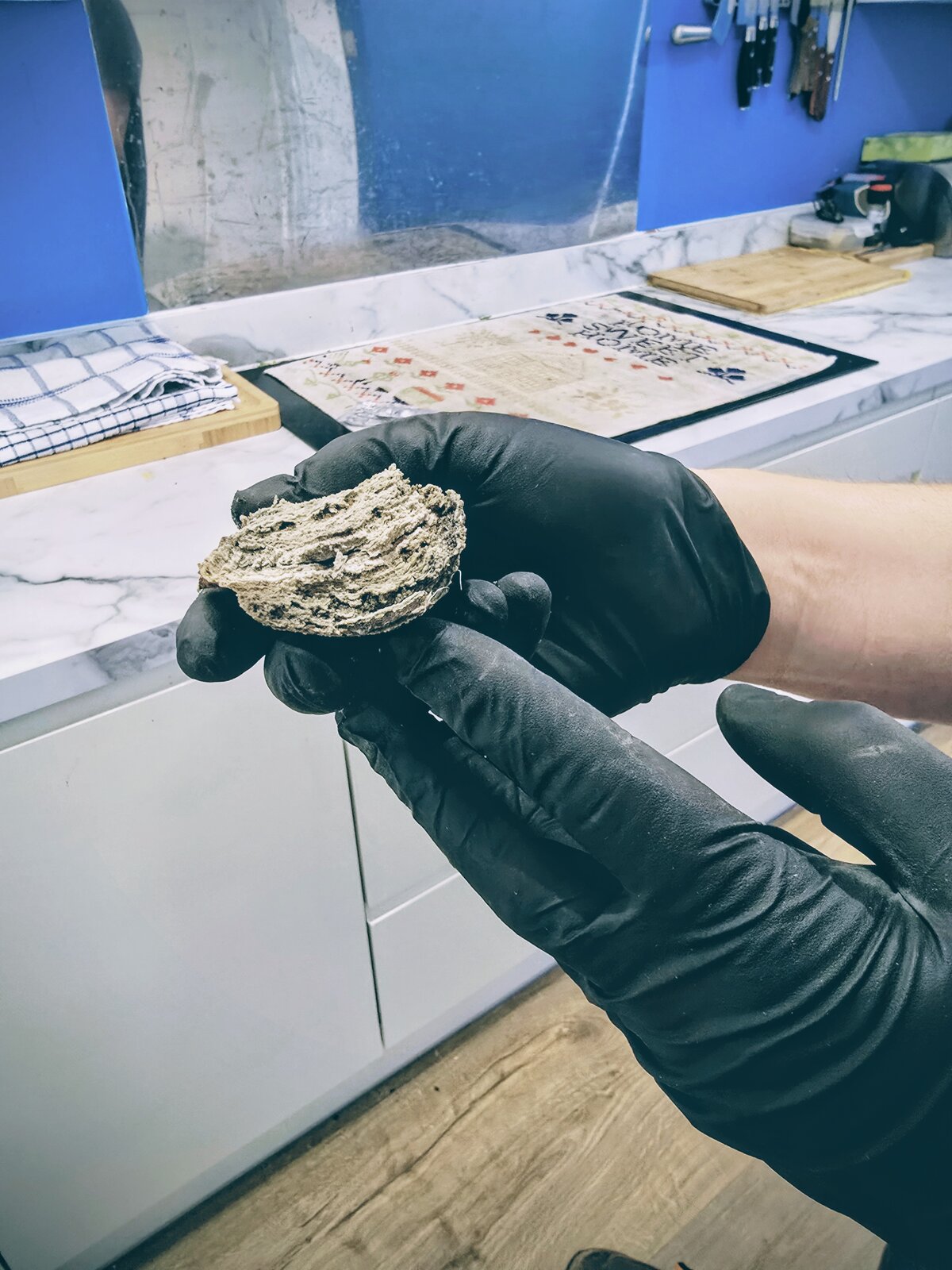

It highly likely to be limescale mixed with a cocktail that goes down our loo's.
This obviously depends on the area we live.
Im in West Essex and the limescale seems to be getting worse.
Ive noticed it more this past year than ever before.
These pictures are from two or 3 separate jobs in 2025.
The picture below, was the trap of a toilet pan, majority scaled up.
View attachment 390845View attachment 390846
That's unbelievable. Certainly would explain a lot.
