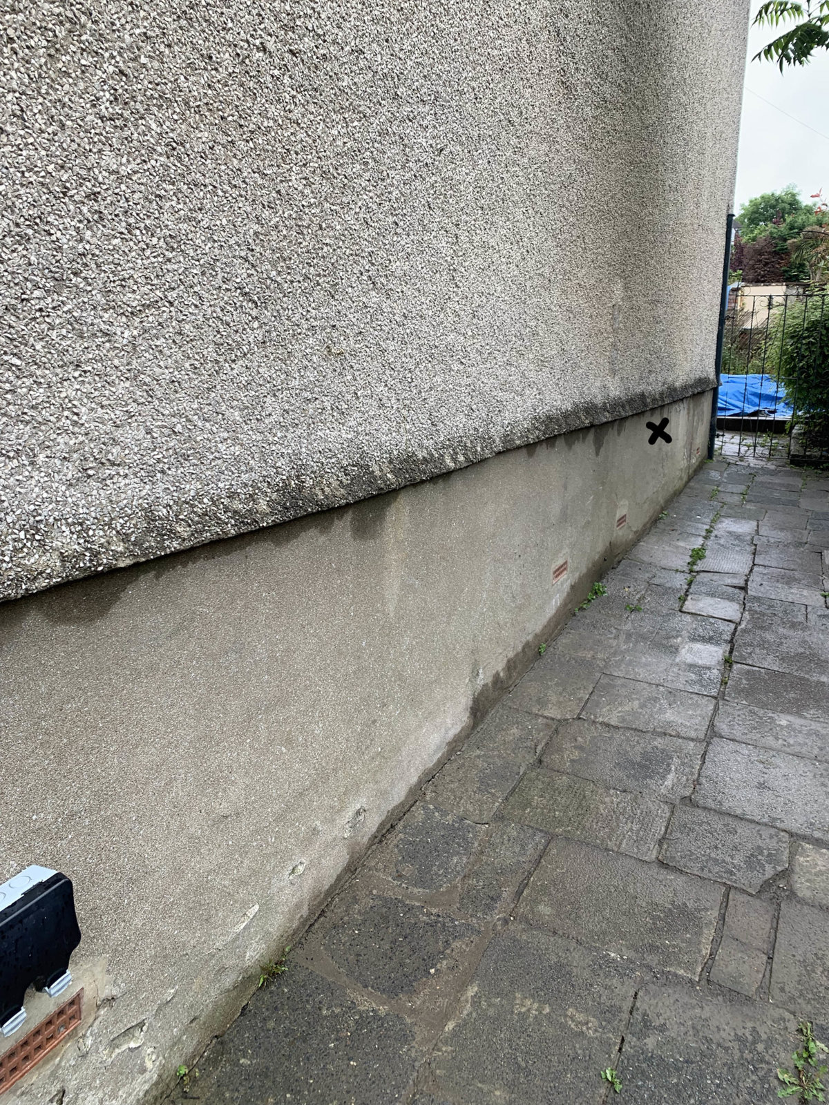

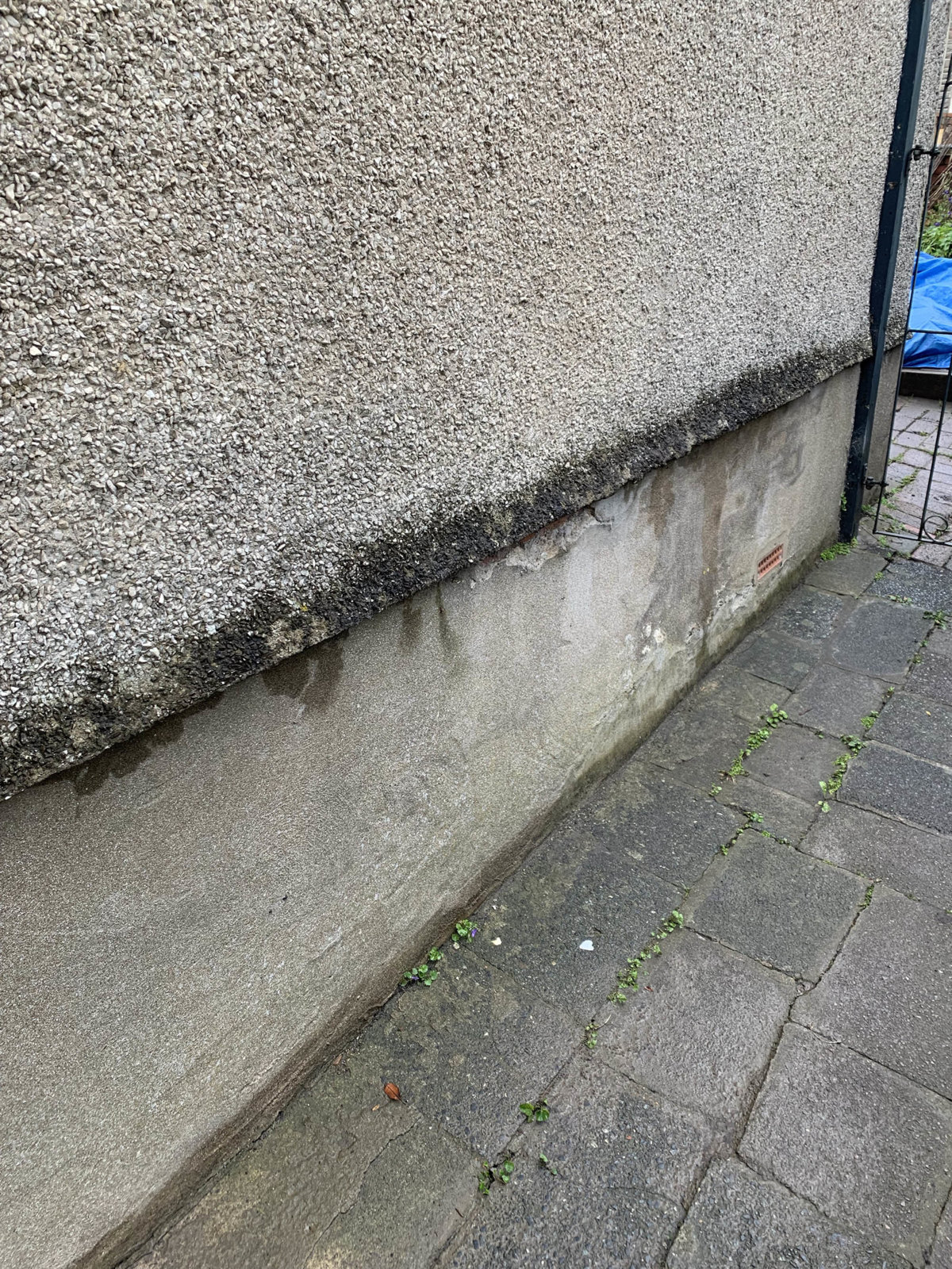

In the meantime before I lift floorboards, here is the external wall to the end of terrace house we are in. The fireplace in question is roughly where I have marked the X.
There is a gradient to the path (and whole house) and so the 1st airbrick is closer to the path than the 4th airbrick.
We will be hacking all this cement off in July, drying out and rerendering with lime. The bell cast will be sorted out and painted in breathable mineral paint.
If ground levels are in issue, I have about 2 weeks to sort out before scaffold goes up!

As there is render right down to ground level, any moisture can be wicked up by the render, breeching the houses DPC (just above air bricks) and continue it's journey transferring moisture into your floor joists/boards.
If it was mine to sort, I'd look at taking the render off, perhaps you only need to do it, a brick above the DPC level.
Also I would make a pebble trap along the length of the house... Cut a trench 8 inches wide from the house, and 6 inches deep, scoop everything out, fill with large-ish pebbles.
It will stop moisture transferring to the wall, and with the render hacked back, will stop it advancing up the wall.

Agree on the render and it is all coming off next month, I have put in a french drain before on a basement flat and see them recommended alot to sort damp problems. Current thinking is a proper bell cast on the render dripping on to new path flagstones that slope and immediately run water away from the house.

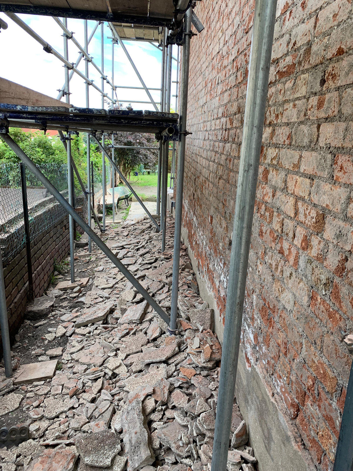

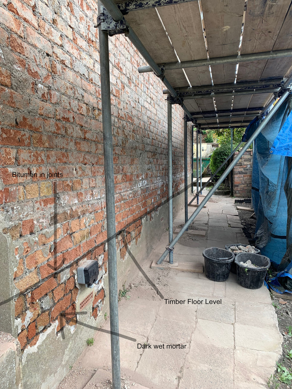

An update on the house/damp as we have hacked off the cement render (painfully slow process) to be re-rendered in lime.
The grey lime mortar is mostly nice and dry above the bell cast but the lower level of bricks and mortar were damp and smelt of damp soil when hacked off. Waiting a few days to see if this drys out in the sun and definately considering either a trench of gravel or a french drain alongside this side elevation now.
We have just ordered cast iron replacement air bricks (supposed better air flow than clay air bricks) and considering another air brick as per your suggestion for front elevation, doing this as the render is off it makes sense to do at the same time.
The bitumen dpc is cracked in several places with clay soil underneath but thats no surprise really as the bitumen is probably 130 years old.
Still high humdity around the chimmney but will be interesting to see if this drops as more cement is hacked off. Keeping posting updates as I hope this journey will be helpful for others and I very much appreciate the replies and advice.
