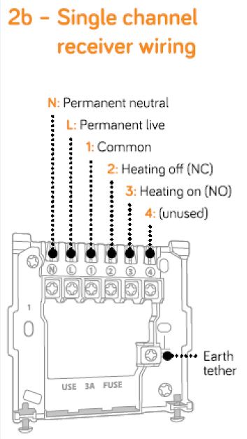

For a combi You should have a Hive single channel receiver like this:

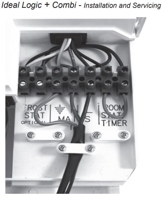

......as you don't give details of the version of Ideal Logic that you have, I'll base it on the diagram I have below. (If yours is different post back the details)
The Hive receiver N & L connect to the boiler mains N & L supply so that they are supplied from the same 3A fused spur.
The wire loop in the terminals marked Room Stat / Timer is removed. One of the terminals connects to the Hive (1) 'Common' and the other to Hive (3) 'Heating on' it doesn't matter which way around.

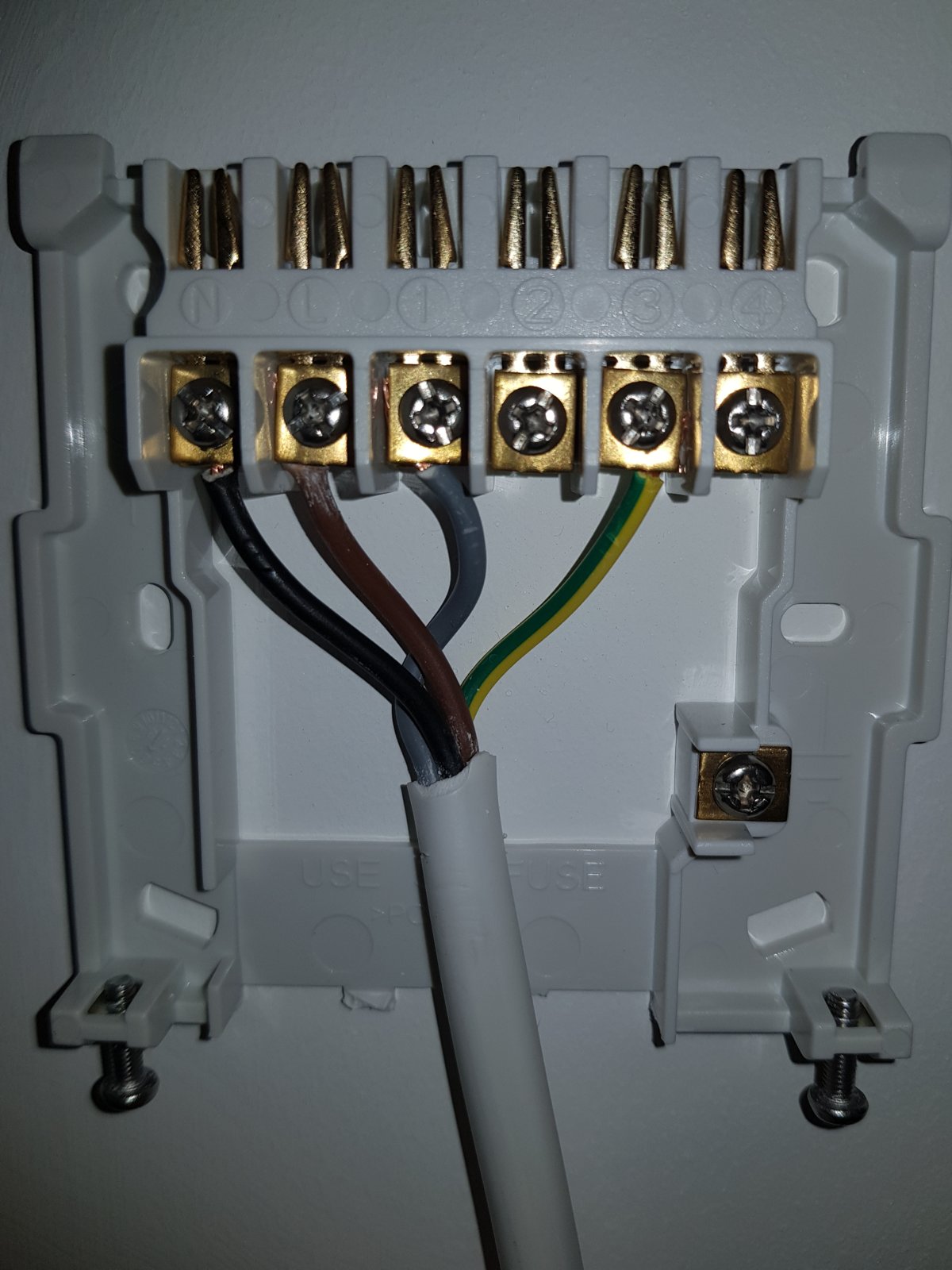

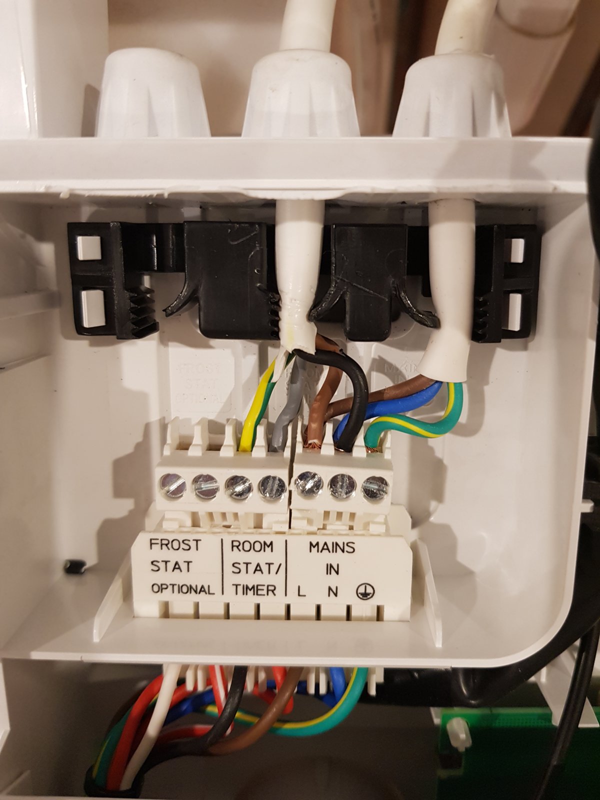

Okay. The wiring of the stat has been carried out but the boiler does not want to fire in when I am turning the stat up. It only kicks in when I manually press the button on the box that is wired to the boiler.
Is there suppose to be a link from permanent live to common 1. As I have seen this on other wiring diagrams.

Current state.
Attached.
As above, you shouldn't have removed the cover of your boiler unless you're capable of carrying out the regulatory 26.9 checks before it's used again, and you aren't capable of doing that because you aren't Gas Safe Registered. Probably a good thing that it doesn't work now you've fiddled with it - you can get a registered engineer out to carry out the safety checks and fix your wiring faults at the same time. Using an Earth as a live conductor is a big no-no, for a start
If by that, you mean the manual button on the Hive receiver, then the wiring is correct, as that's the only place the wiring goes! The problem will be with the communication between the Hive thermostat and Hive receiver, in that the thermostat is not switching the receiver on.
As above regarding the green/yellow, and also the blue wire, which at least should have a brown sleeve fitted over to show use as a live wire.
No, you don't need to do that the way your boiler is wired. If you needed it, it wouldn't work now when you pressed the manual button.
