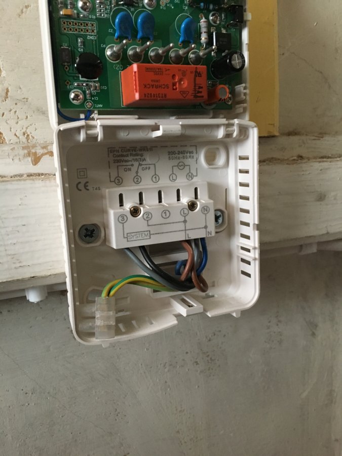

Just got a question about installing hive active heating 2, I need some advice on the wiring please,
My current setup is a ideal independent c35+ boiler which has a eph controls wrs1i receiver wired to it, and a wireless thermostat downstairs

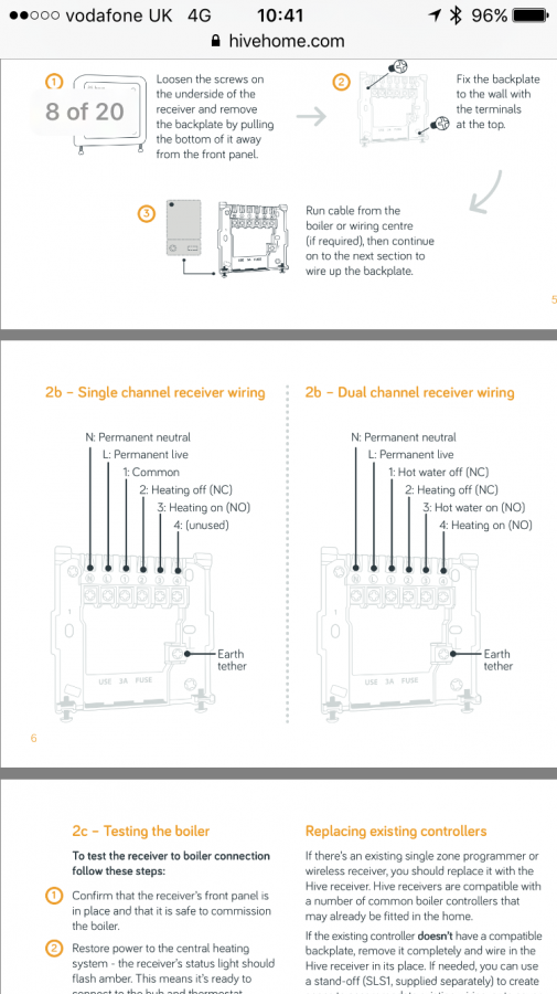

My question is can I just simply swap wiring from the current receiver to the hive active 2 receiver, I've had a look at the hive wiring diagram but I'm not 100% sure, don't want to be chucking an extra 80pound to get it installed if it's just a simple swap over,
Pictures should be on here of current wiring of eph receiver and the hive instructions (diagram on the left)
Thank you
Brown Live
Blue Neutral
Earth to Earth
Black to 1
Grey to 3
Done. This is about as simple as an install gets.
