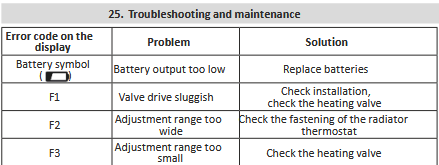

The eQ-3 head does not show current, only target, but does have an auto fault-finding,
so I know if the pin is stuck. I have Energenie, Kasa, eQ-3 and Wiser TRV heads, each has some plus and minus points. Turning the wall thermostat up so that the TRV's do the room control, even if the lock shield is wide open, as each TRV closes it forces water through the next valve which is still open, assuming they are set to around 20ºC to start with. And once done once and water has gone through each valve, it tends to keep flowing.

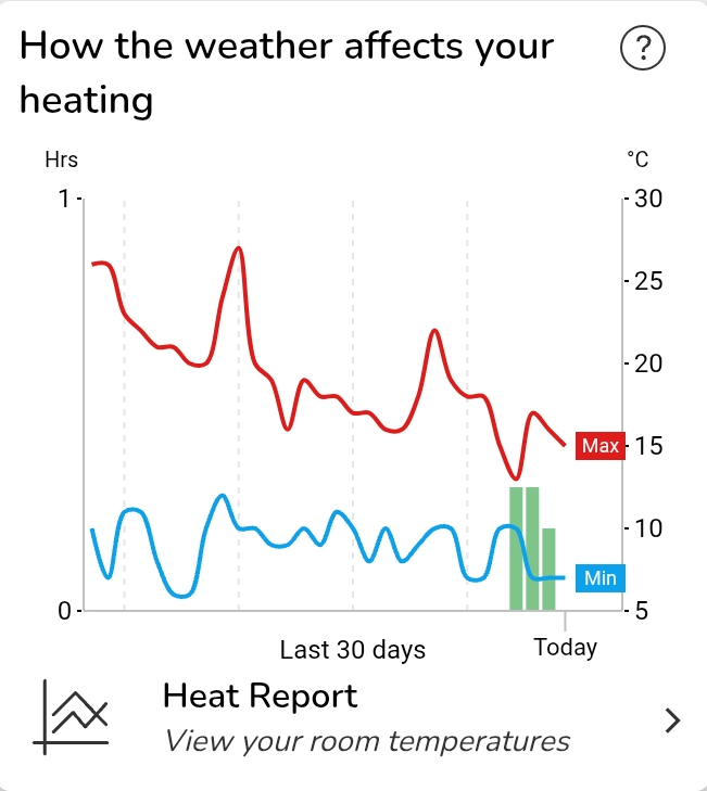

Today if the first day this season the boiler has run
the app shows the temperture and when boiler was switched on by Wiser.
