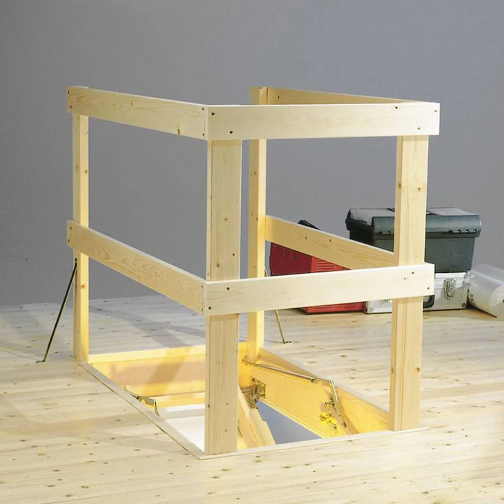

Nothing wrong with it being in a loft but be aware that you need a good quality loft ladder with a hand rail round the top, a fixed walkway, and a work platform around the boiler. Any less and manufacturers are likely to refuse to work on it in the event that you need to call them out under warranty.

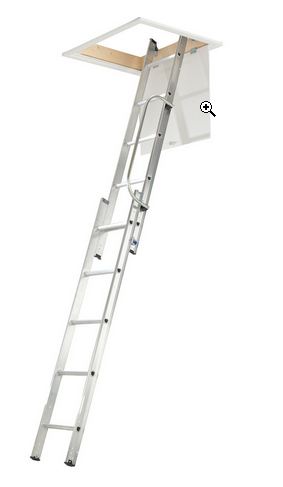

Thanks, yes that part of the loft is already boarded out for the existing pipe works etc and have a two part aluminium loft ladder that slides up and is stored in the loft.
What we cannot be sure of is the hand rail, is that a rail thats attached to top end of the actual ladder, which only extends about 300mm above the loft boarding, or is it a fixed rail around one side of the opening in the loft ? which we could more easily make and fit.
The guy who checked the loft did not mention anything about it.

Thats the point I was asking above as to whats considered an adequate hand rail ?
Our existing one is similar to this, but without that small handrail but our does go about 300mm higher into the loft.
Our loft has T&G chipboard flooring from the loft hatch to the gable end wall ( 5ft and 8ft wide) fitted by the original builders for the water tank etc and it has mains lighting.
