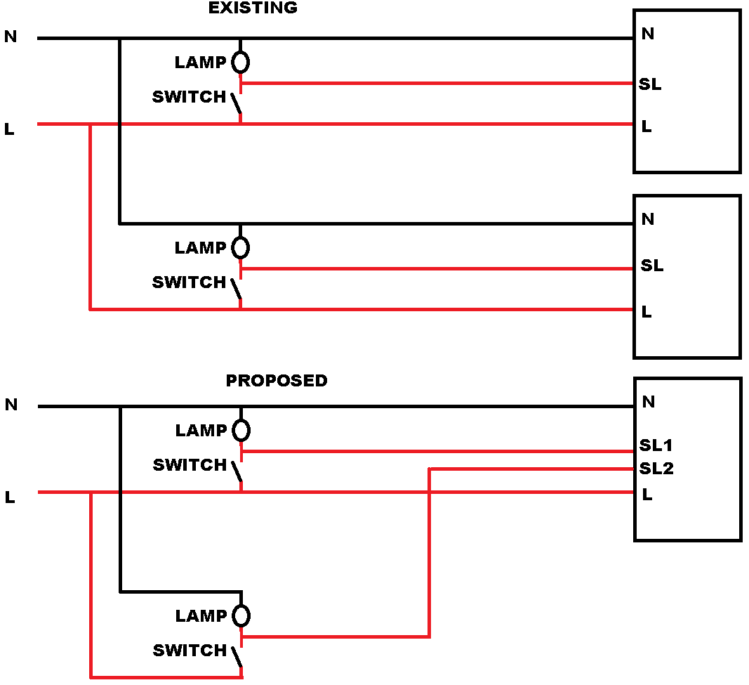

    We have 2 bathroooms located near each other both with their own extractor fans but I've just noticed one of them is venting in to the roof space?! The other is venting through a roof tile vent.
    I'd like to combine both so they are venting out of the existing roof vent. I've seen 2 suggestions on how to do this - either add non return valves and a y piece (so when just 1 room is on it doesn't just blow in to the other room) or put the fan on the vent side of the y piece so it sucks from both rooms.
    I prefer the second option of a single fan but can't get my head around the wiring for it. They're both wired conventionally at the moment (switched live, isolator switch etc) but on 2 different lighting circuits.
    Any ideas on how I could could combine this in to 1 fan or will I need to go the 2 fan route?
    Thanks in advance!

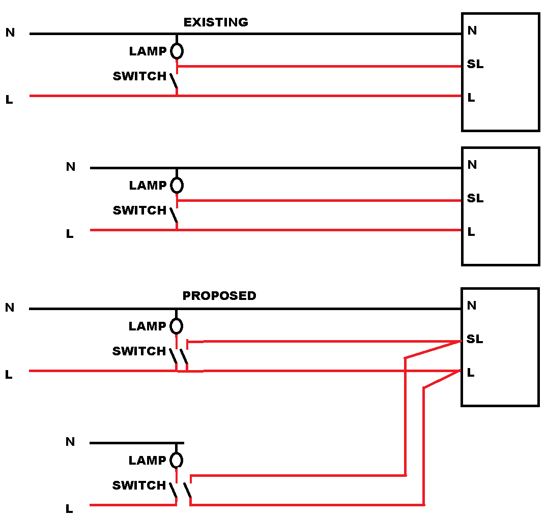

    You need double pole switches in each bathroom. One pole does the local light and the other pole the fan. If the bathrooms are really on different lighting circuits you are going to have two different circuits on each pole of one of the switches.

    First, let's try and assertain the detail;
    Are they on the same fuse/mcb in the consumer unit?
    If they are the answer is easy - inline fans are available with more than one switched line input and all that's required is a single conductor:
    If they are on different fuses/mcb's and the wiring easily accessible, ie pull switches wired from the loft then winston's idea of double pole switches works, this method will also work insted of the multi input fan above:

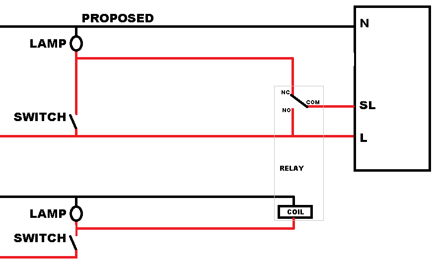

    Another, and OFTEN THE LEAST DIFFICULT/DISRUPTIVE, option could be to fit a relay,this doesn't require replacing switches or adding wiring to existing switches which may be chased into the walls:
    I don't know your current installation methods or where the wiring loops in&out (switches or light fittings) so I've only sketched generic circuits I/we can help with more detail.

    Great thanks SUNRAY - really helpful. They are on different MCB's so I like the idea of the relay for simplicity. Any recommendations on stockist / brand of relay to go for that includes a mount?

    Try these https://www.tlc-direct.co.uk/Products/SR501.html
    the base is detailed also.
    You will need to find an enclosure to put it all in.
