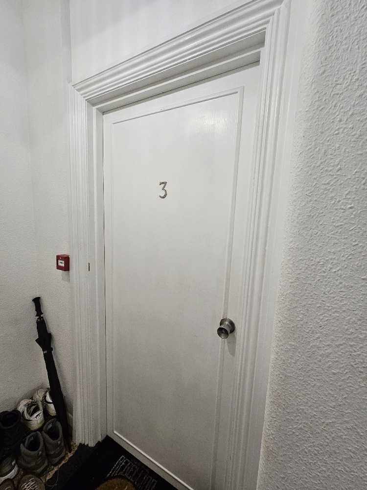

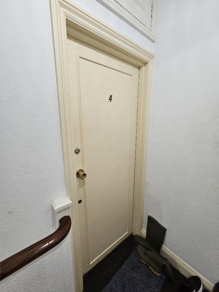

Hello,
With a neighbour, we want to redo the communal hallway. Paint wise - Couple of thoughts – questions:
1/ Should we stick to white so to keep it neutral? And if so, what type of white as when looking online, there are so many options.
Or should we embrace and be creative and make the hallway a statement with specific colours?
2/Woodwork
  • Each door flat and wood frame door
  • Skirting board
I have used both Gloss and water-based products before and understand that gloss is trickier to apply and takes much longer to dry.
When I redone inside my flat, went with water-based for wood work and curious if for communal hallway, we should stick to gloss as much more traffic (only 4 flat) but easier to whip clean too.
Many thanks,
Use a waterbased satin in white.
Will stay white.
In the future a 320 grade quick rub over the satin and a clean, then one coat of satin with freshen up.
Easy maintenance...

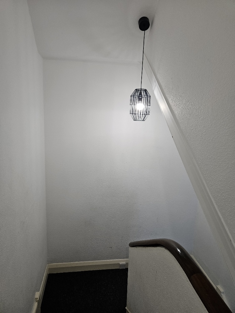

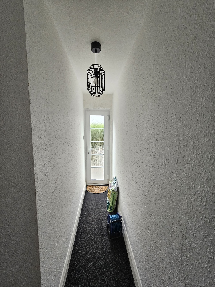

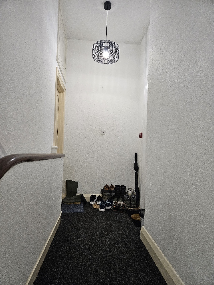

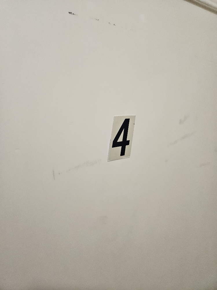

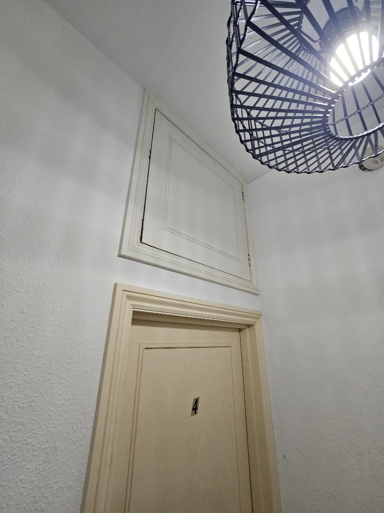

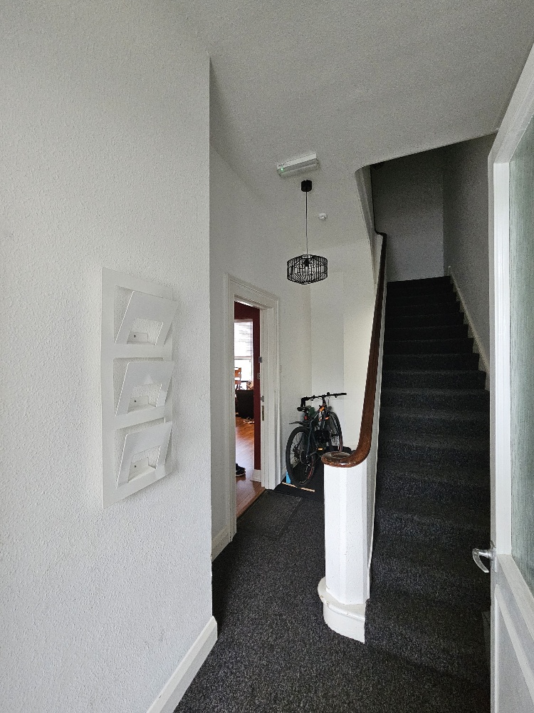

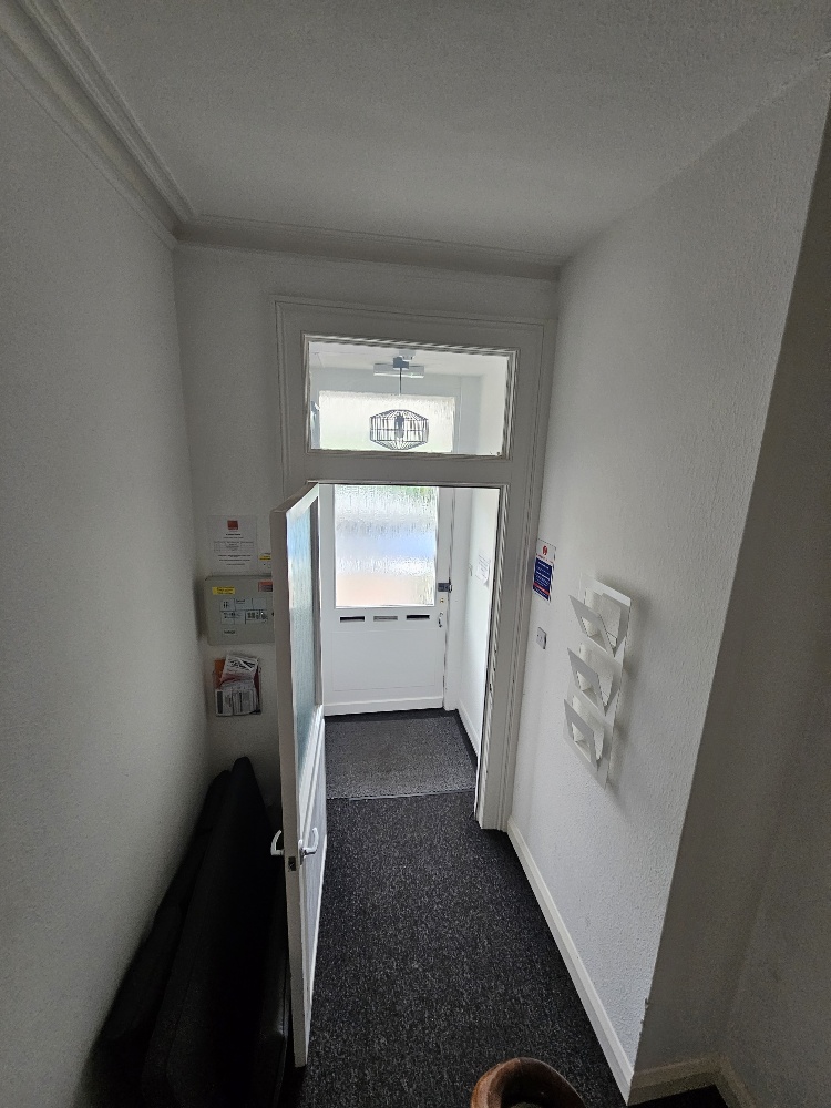

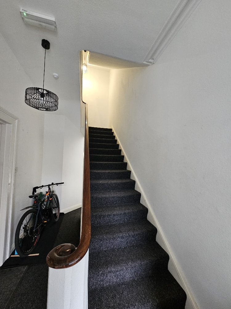

Pics so to show lights in the communal hallway. 20250720_120652_resized.jpg20250720_120655_resized.jpg20250720_120701_resized.jpg20250720_120711_resized.jpg20250720_120722_resized.jpg20250720_120736_resized.jpg20250720_120825_resized.jpg20250720_120833_resized.jpg20250720_120836_resized.jpg20250720_120839_resized.jpg
After viewing your additional photographs, I am even more inclined to suggest either white or magnolia for maximum reflectance.
Not too gloomy. Since it’s already white, repaint in pure brilliant white unless you fancy something fancy. (Do you want something fancy?) Water-based satin per @Wayners above for woodwork.
Thanks for the advice, guys. I thought that Oil Gloss would be stronger and easier to maintain than water-based satin finish for a communal hallway - is there any specific reason of the recommendation for the water based satin versus oil based gloss?
