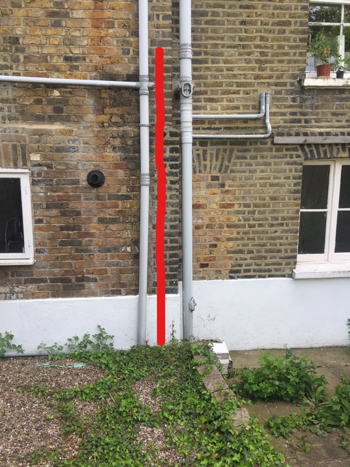

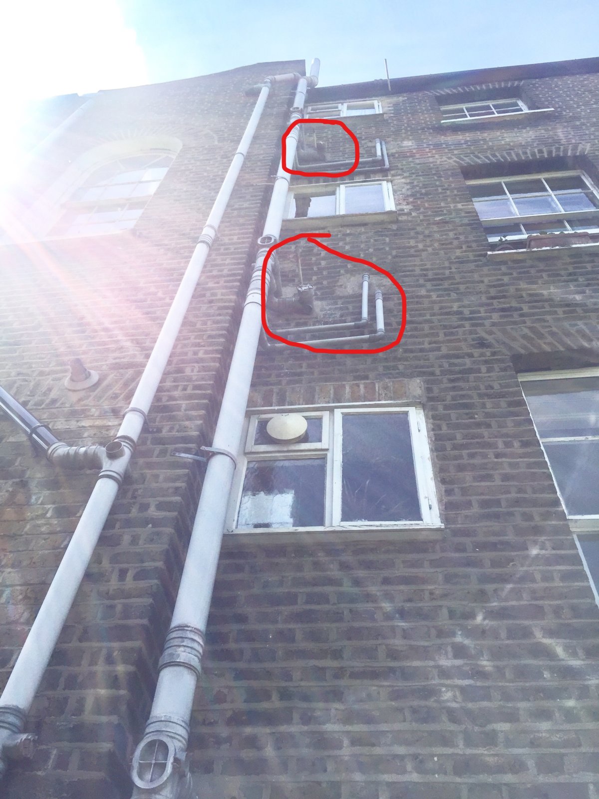

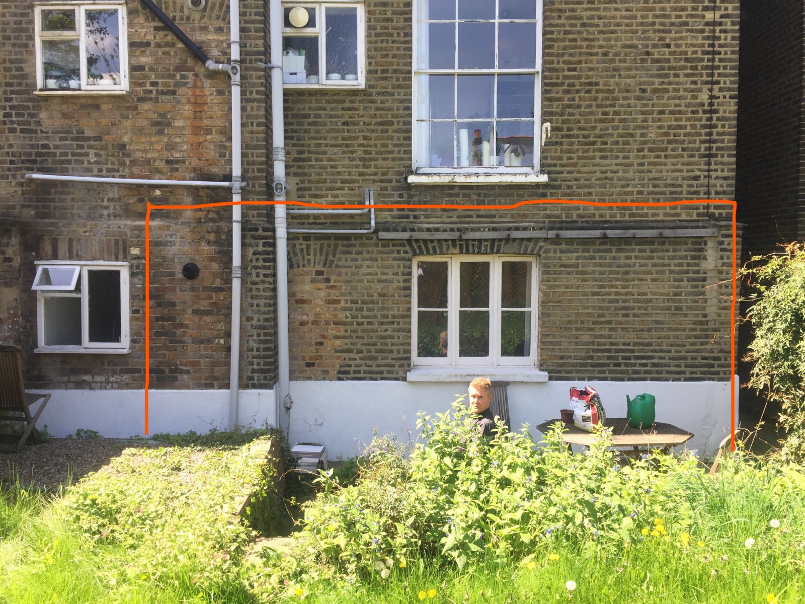

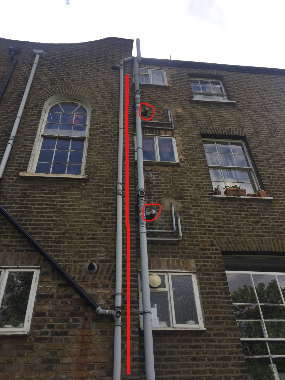

Hello all,
This forum has been my source of some valuable information for me over the years, I've got a problem with a soil pipe which is in the position of a doorway to an extension I'm planning on adding to a ground floor garden flat in London. I'd like to move to soil stack to round a corner of brickwork to an alternative position (highlighted red) but not sure what effect (if any) it will have on the soils to the WC of the three flats above. It's a Victorian conversion and the current soil are almost past their shelf life. I've also added the area that the proposed extension will sit and circled the WC soils which come out of the back of the building.
Any help would be greatly received and appreciated......thanks in advance!!
Michael

I think your best option will be to put a new full height stack in at the new position, and then reroute the branches from each flat into it. Putting bends in to divert the existing stack, especially when waste is dropping from that height, may not be allowed, and if stack is that old and brittle, it may not take kindly to being messed about with. Speak to Building Control and see what they'll allow.
Thanks guys, I'd be looking at fitting a new stack and ancillary waste pipes but wasn't sure if adding two ninety degree bends next to each other to connect to the new soil stack position back to the WC would cause potential blockage issues?
90 bends externally shouldn't be too much of an issue if the correct fall is used.
90s are ok as long as they can be cleared, but the poo will move slowly around the bends. you could do two 45s instead and side step the issue.
