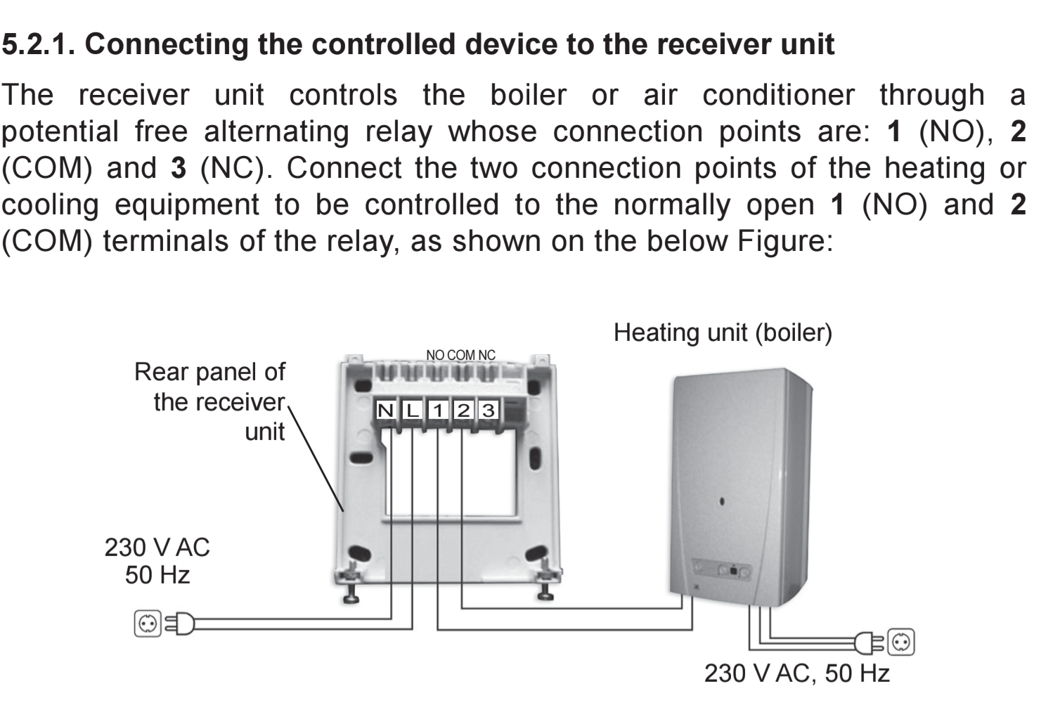

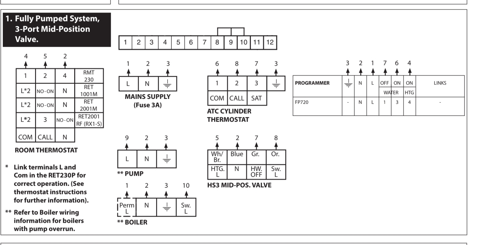

I need to replace a basic room thermostat with a Computherm Q72RF. The central heating system is wired up via a Danfoss WB12 (3 port mid position valve).
I've attached both the relevant page from the Q72RF manual and the WB12 wiring diagram, and would be grateful if someone could tell which terminals on the Q72RF receiver need to go where in the WB12 please?
I'm assuming N & L on the stat go to 2 & 1 on the WB12, but not sure about NO & COM. 4 & 1 perhaps?
