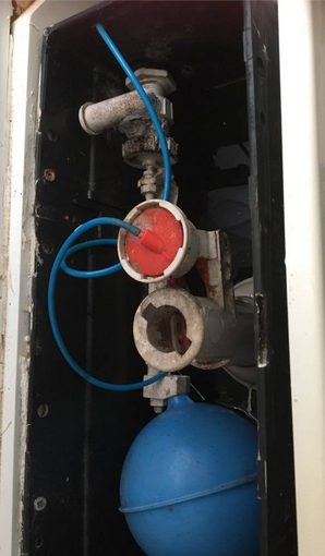

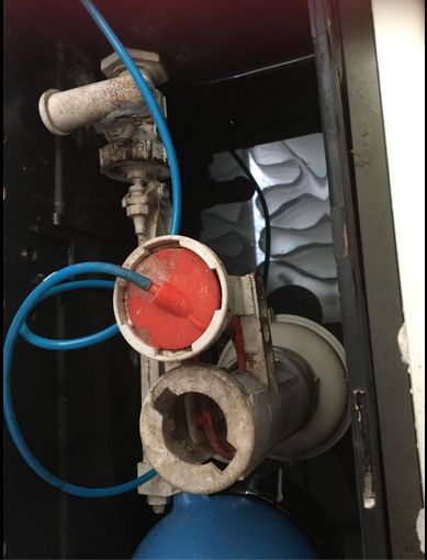

My cistern has been really slow to fill with the water really just trickling in. It's also been a sod to flush with you having to pump and pump at the button to get it to flush.
So I've hauled the worktop off and had a look inside - not that I know what I'm looking for lol
The water was just trickling and I lifted the ball cock and let it drop and lo and behold, the water started coming in like it should.
With the worktop and lid off, it's flushing ok as well but clearly I can't leave it like that.
Can anyone give any ideas of a fix please?
If I need to replace bits, how do I find out what kind of cistern it is? I don't see any names on it or anything - and is all that tubing really necessary or can it be cut back so that it's not all coiled round?
As they say in the action films. No don't cut the blue wire! It is your flush operation fixed both ends you will not be able to just join it again.
You just need a new diaphragm in the ball valve there are different types but chances are that is a basic one like this.

That's a pneumatic operated flush valve. The "blue wire" is an air tube. It will just pull off the red cap and can be cut to length.
