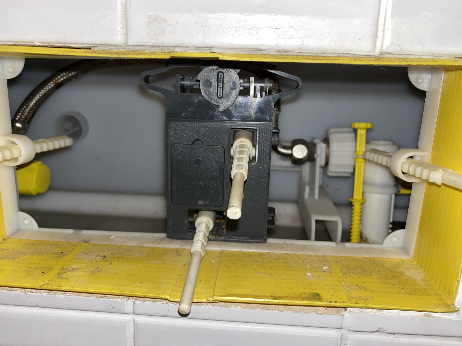

Hi There,
I've just moved in to a house that has a concealed toilet Cistern. Not something I've ever had or worked on before so it's all a bit unknown. The make of the cistern is by Viega. The toilet flushes and cistern fills perfectly, no strange noises, no leaks from split washers etc. I noticed yesterday that there is continuous flow of water going in to the bowl. It is so little you can't here it but can only see it by the water movement. It comes from the centre of the bowl at the top. Has anyone got any ideas on how best to remedy this/ what may be the cause? I've attached some pics, have a video but unable to post
Many Thanks in advance

Lets start with the easy stuff. I`m thinking the water level looks a little high, so if correct then it could leaking via the inbuilt overflow. The level adjusters can/do move over time and the adjuster screw is the Yellow rod in picture 2.

The Viega has a silicon disk that stops the water flushing as it fills.
This disk bubbles and let's water trickle between the bubbles. The disk comes as part of the Viega service kit (Viega Flush Valve and Filler Valve Seal Set 405557)and is about GBP7 from https://shop.kingswayplumbing.co.uk/
Check the Viega system type and if any problems call Kingsway - they are very helpful.
