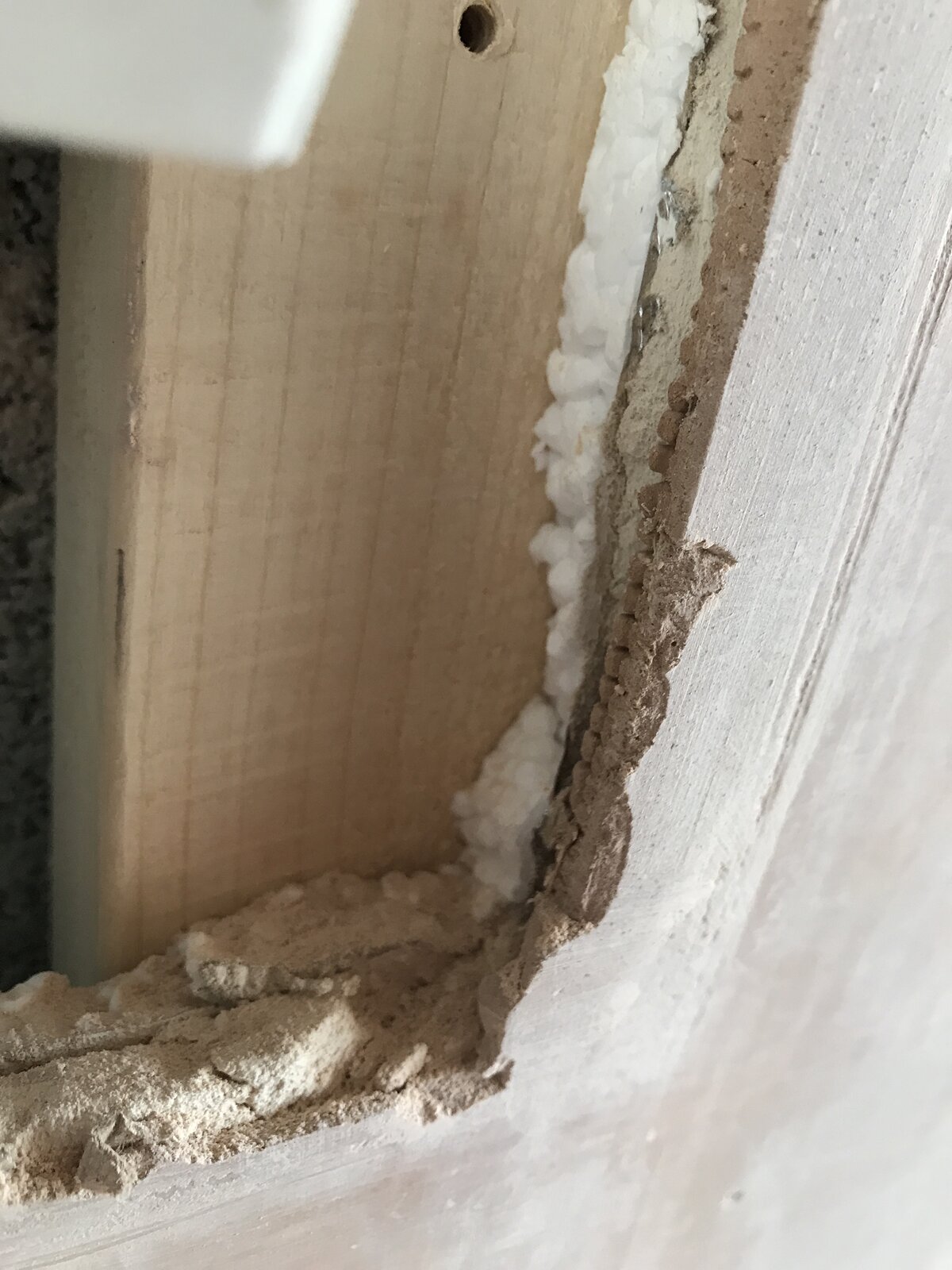

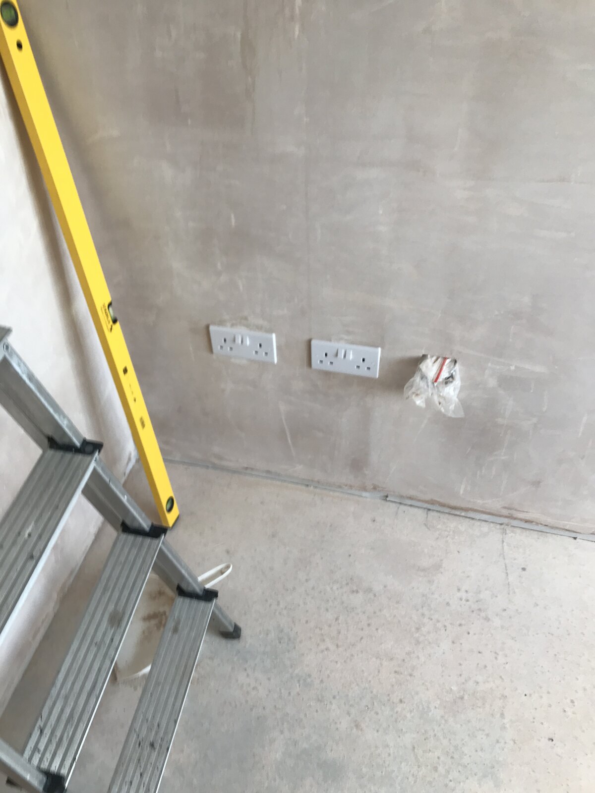

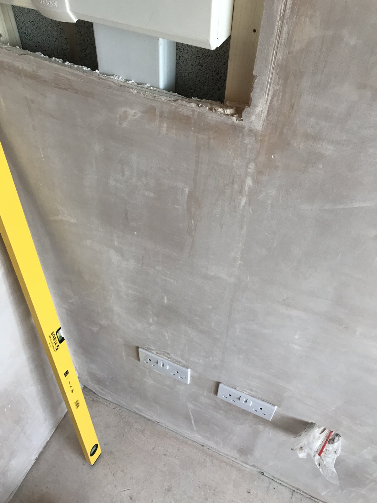

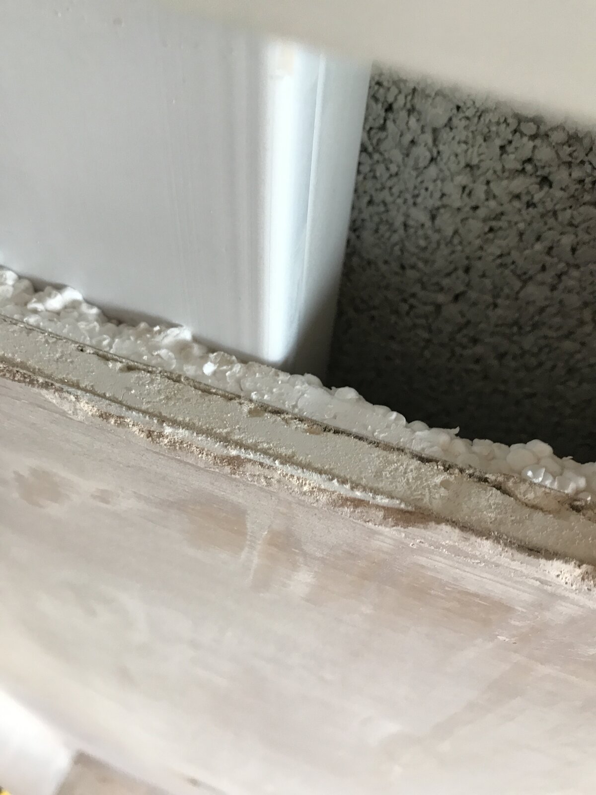

I hope someone can give me advice. I had my garage converted by a so called professional builder.
he has battened a breeze block cavity and put polystyrene backed plasterboard onto the battens before plastering. Please see images attached. The electrician drilled through the battens beforehand and did all the wiring. He didn’t use conduit. The polystyrene plasterboard the was fixed to the battens. Is this safe? And should building regulations of flagged this?

Only issue I can think of is if the wire is not run in safe zones. Do you have a before plasterboard picture?
I don’t unfortunately. The wires were run through holes in the battening. With it being polystyrene backed plasterboard with this cause problems with the wiring if it’s not in conduit?
I believe it is fine. Although it's hard to match with an official installation method. Putting it in conduit only decreases the current carrying capacity. All the standard methods will allow at least 20A, which is what is required.
Ah. So that's your concern. I don't know enough about the type of polystyrene used to give a useful opinion on that. I guess it also depends on whether it's touching, and whether there is any protective film on the back. Do you have a manufacturers id of the boards used?
I don’t know what the builders used. There is the same amount of polystyrene to plasterboard and there seems to be a silver foil inbetween the 2 substrates.
OK - doesn't sound too great. Of course, without photos you don't know if the builder added any protective barrier. Probably not. It's beginning to sound as though you need to ask him some carefully worded questions. Maybe withhold payment till you are satisfied with the answers?

As I understand it, there is a potential problem with PVC cables being in direct contact (no intervening film/whatever) with at least some types of expanded polystyrene. Is that no the case?

Yes. And it looks like this may be the situation in this case.
So the electrics have been wired directly to my fuse box with 2 new RCDs I think they are called. 1 for lighting and one for sockets. Should this polystyrene plasterboard have been passed off by building regs?

You won't find anything in the Wiring Regulations specifically about polystyrene and cables, but there is plenty about protecting cables from environmental hazards - so if the cables are in direct contact with the polystyrene, there could be a problem.
