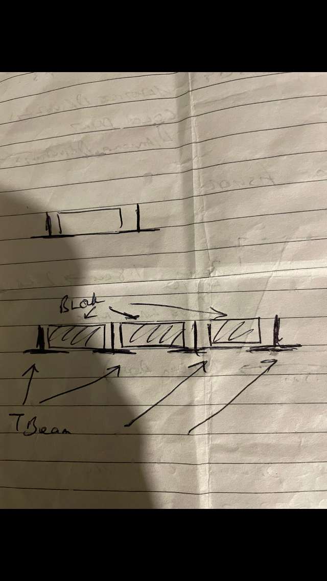

The outhouse is block built with I beams supported across roof span.
Between beams are blocks again .
Just like a house foundation ..
Then dpm sheet over the blocks & 8mm mesh supported on 40mm stand off blocks.
So we’d like to know about the weight of concrete and load acceptable to finish the roof off?

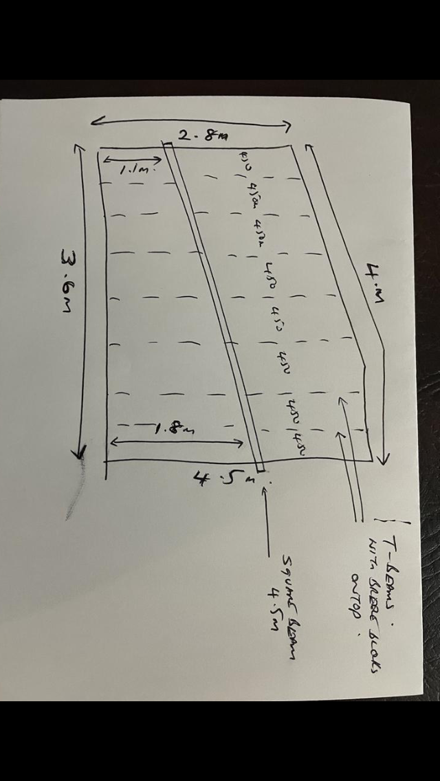

We wanted 4inch with a slight run off down to 3.5”.
The concrete guys said it’s about 5 tonnes of concrete that we need .
This sounds a lot, but we know our works solid.
We’ve even fitted a strengthening steel under the beams , inside the outhouses ceiling . It’s running diagonal on ceiling & supported on 2 walls.
So any thoughts if we need to reduce the depth of concrete?

There’s beams spanning 215mm centers approx.
There’s 7 beams.
With approx 60-70 , 7.3n blocks between beams.
Between each T beam is a row of 7.3N blocks
T beam is 10mm thick steel.
The T beam is 100mm high, from where blocks sit on , upto top of block.
So the T beam is inverted T , with T upside down & the blocks between each beam, sit on the T by 50mm either side.
Also under the roof . Up at ceiling height is a box section 3” x 3” that spans all T beams , for extra support. And it’s resting on both ends, being inserted into block and darbo’d up & slate packed.
Finally-
The lengths of the t beams gradually decrease ,due to the outhouse shape .
One supporting side wall of the build is following the natural run of the road ,so 3 walls are standard 90’ square bulid, but 1 wall is diaganol. Creating a odd shaped room. Basicly imagine a box room that’s disected in 2, making a diaganol wall.
The beams start at 4.5m long and decrease in length until the last beam rests on the wall to wall at 2.8m long

That's heavy. You need it worked out properly.

Do you need 100mm?
At 16m², 50mm depth using an online concrete calculator I get .8m³, seems to be 1800kg, could you not screed it instead 3:1 mix and as dry as possible?
Is it single skin or on their backs?
Won't condensation be an issue?, perhaps kingspan on top of blocks and then concrete/screed with the mesh in.

If the steel beam is up to reducing the span and assuming the reinforced slab is at least partially self supporting then I would be happy with that arrangement, provided the lateral stability of the building is suitable (not a single leaf etc). My only concern would be that wet concrete is heavy and has no strength and I would be using some serious temporary props untill it all goes off. Obviously you really need an engineer to confirm (you might get a bit of help from the beam manufacturer).
