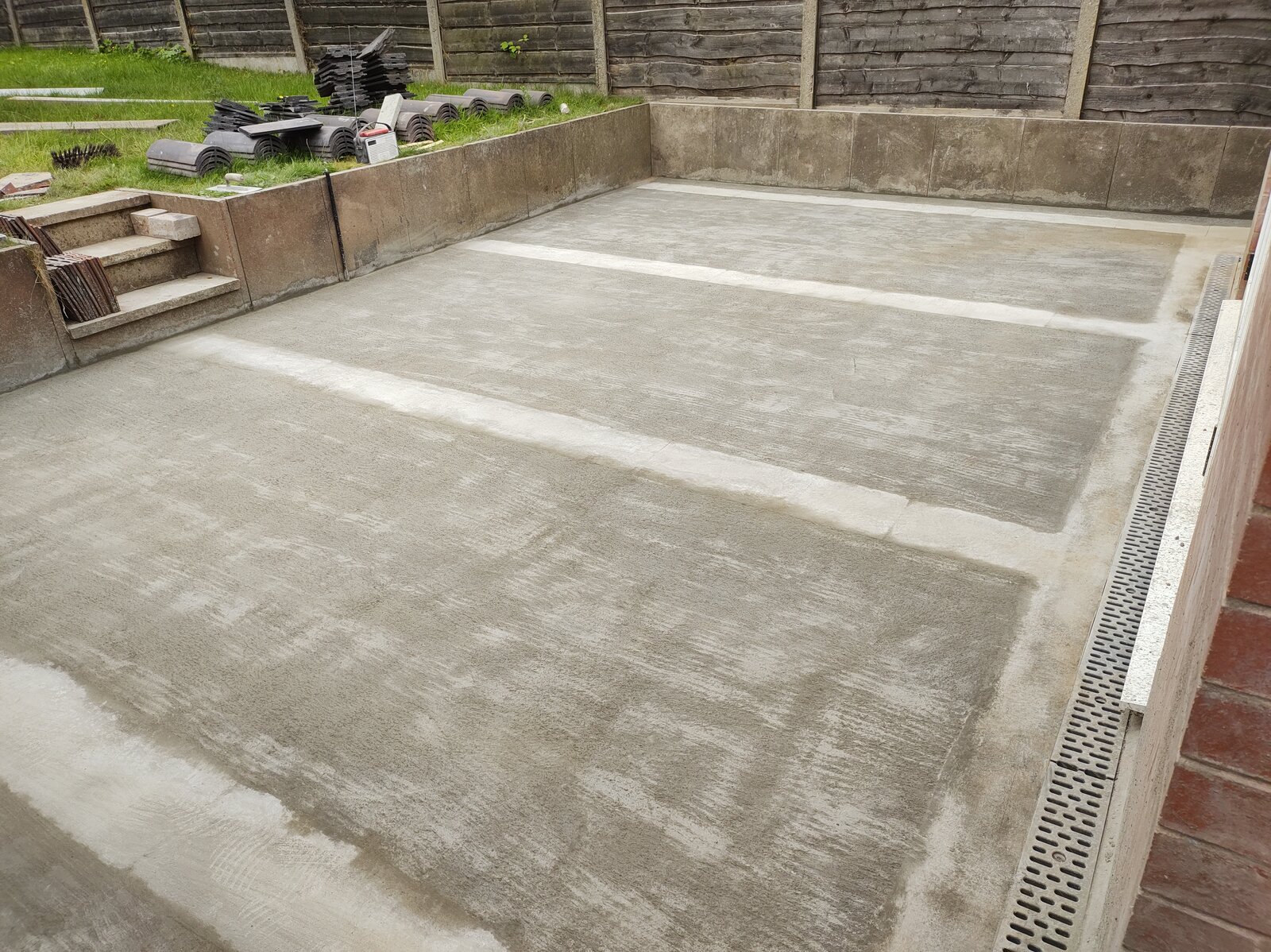

I have a 30m, 4" concrete patio which I will be tiling with porcelain in the future - it's not going anywhere, but is on rock solid clay. It cost me £500 to get the concrete barrowed in and the tamped and brushed finish is good enough use till we've saved up for the tiles. I think it's slightly ironic that we'll probably end up going for concrete effect tiles!
