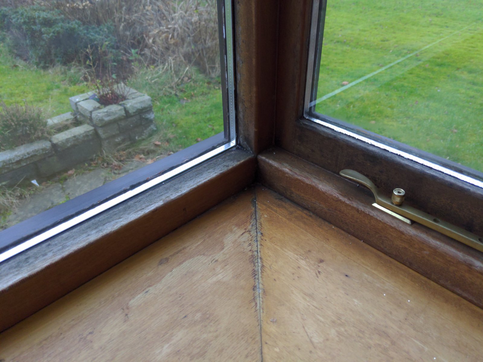

Most of our windows have condensation each morning. The ones in the bays are the worst alongside the bathroom.
The double glazing looks old and narrow, but not blown. There are no trickle vents, roller blinds probably don't help begin so close and hindering air flow. We are now keeping the small window open on the upstairs.
Not sure I can stop the condensation, but trying best to deadly with it. Using a window vac each morning etc.

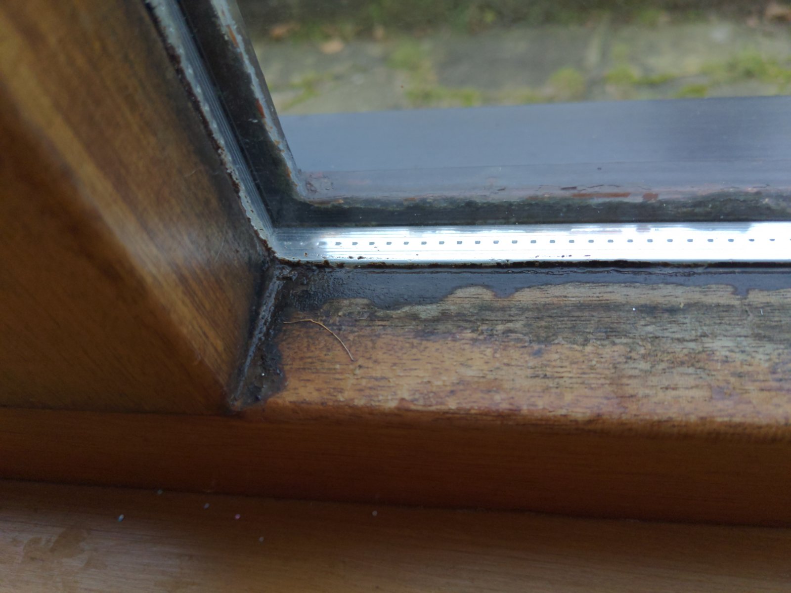

I'm sanding and tree varnishing, however how is best to seal against the Fran against the glass too stop condensation running down and soaking the wood. A thin bread of clear sealant?

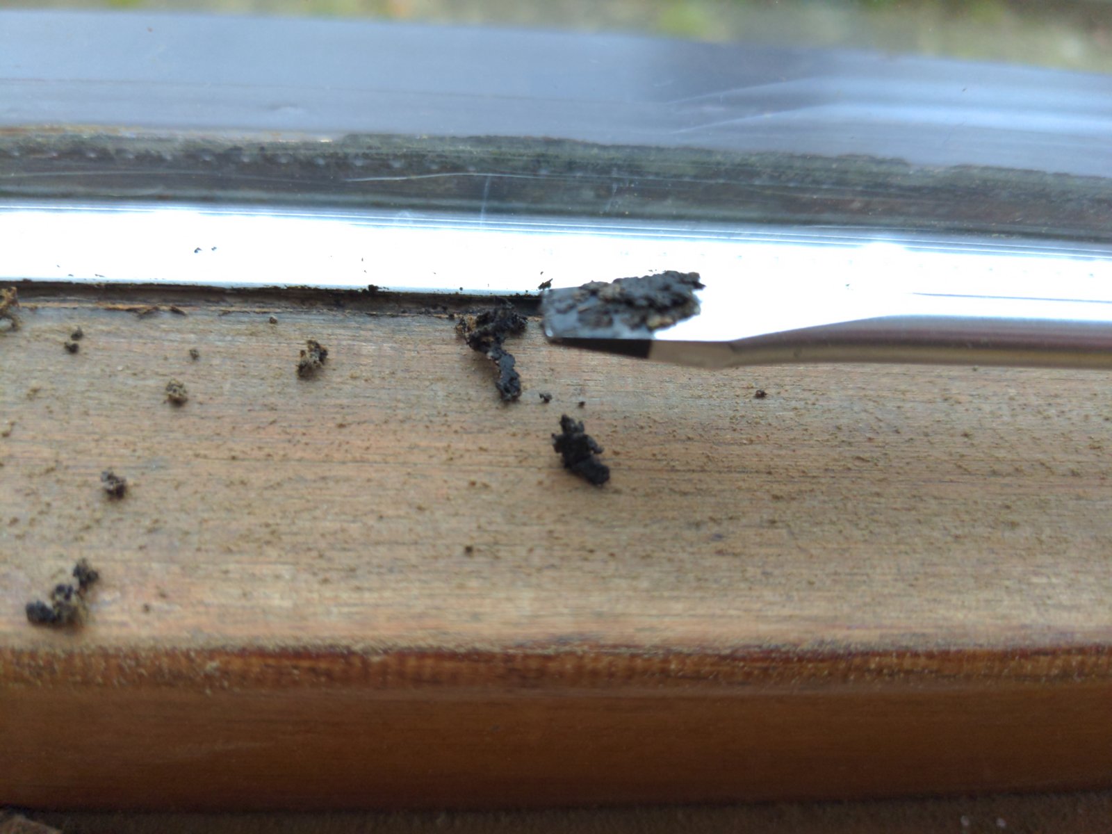

I'm drying the frame, sanding it and there is a bit of gunk where the frame meet the wood. Once the black gunk is out I am is where I'm varnishing the wood and would pop in some sort of sealant? It's about1mm of gunk coming out

Still curious about three best way to seal wood frame to glass. I'm thinking of wood filler too however matching the wood as using clear varnish will need the trick
Sealing the frame to the glass, I personally would use black or brown silicone (anti mould if you can get it), use a proper silicone smoothing tool, not your finger. I'm a DIYer though, someone else on here will know better.
