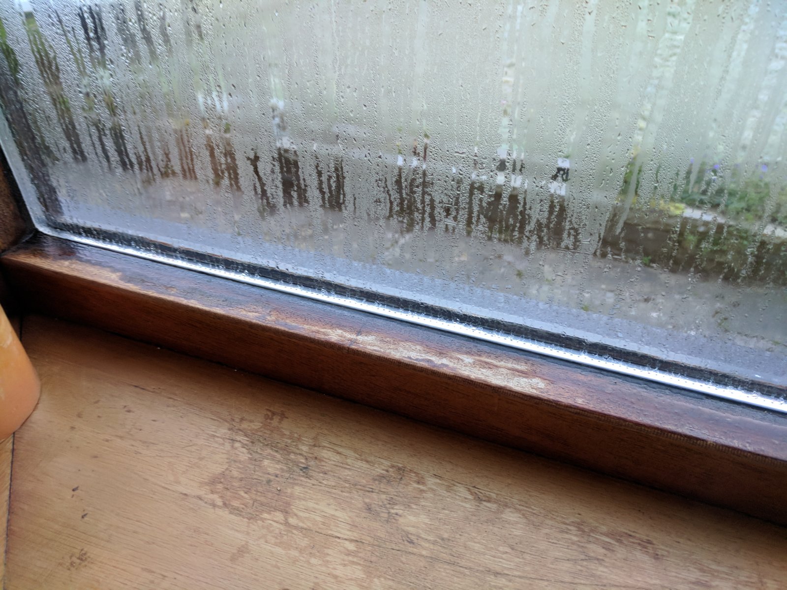

As the title, we have moved to a house, like the wood frames.
The double glazed units seem ok (1 or 2 need replacing), if a little thin compared to modern ones.
We are getting lots and lots of condensation, pools of it on the windows.
(See the photos)
Would you put Trickle vents in?
If so is this a DIY job, drilling holes, to make the slot and fixing the vent inside and out?
Anything else you would do?
Once the wood is dry and am going to sand and retreat to help protect with the pooling water.
I've also got some Spontex Drip Strips to help short term
We use the Bathroom extractor fan and keep that door shut.

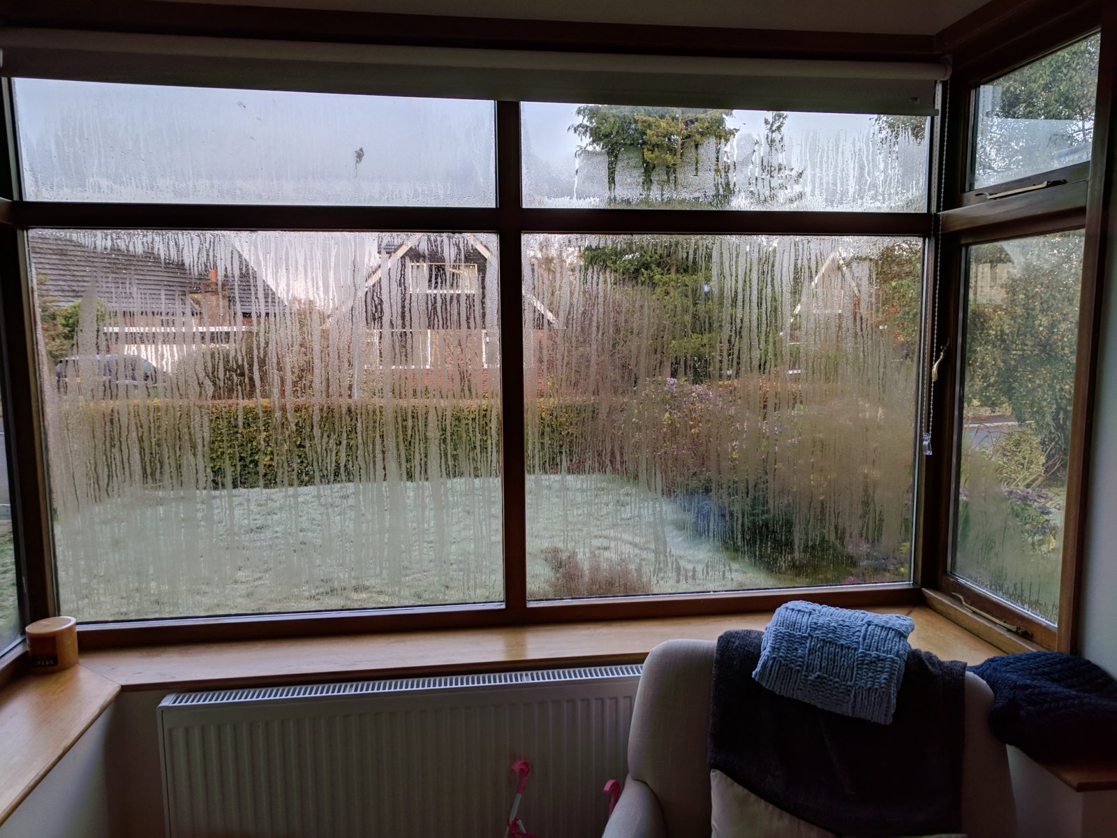

What's the rest of the property got regards ventilation, any permanent vents? kitchen extract? assume you never dry clothes indoors?
that's a lot of water. Where is it coming from? I've only seen that much when there is a leak, or new plaster drying out.
Are your ground floors concrete, or wood? Have you got a water meter?
as foxhole says, Have you got a kitchen extractor? Leave it turned on overnight and see if it makes a difference.
Do you open the bedroom windows every morning?
Please don't tell us you drape wet washing indoors.
Water vapour is lighter than air so tends to rise through the house. Your water is downstairs so there must be a source. Feel under the radiators for a leak.

I left the heating on more last night and it was a dry morning, plus I used some sponge condensation strips on the window cills. Hardly any condensation
I am getting scientific about this, looking at when we use the dryer, when we shower with the door open (hopefully never), temperature and moisture in the air outside.
But I am tempted to fit some trickle vents
Think you've answered your own question. The dryer will not be helping, especially if that moist air is trapped inside.
Try to ventilate more, open windows, regularly.
Trickle vents can't hurt, if you are not a window opener!
IMHO - You definately have a problem which needs identifying and sorting before you worry about trickle vents.
Others have asked about drying clothes inside. I see you have a dryer in the kitchen - is the condesation worse after that has been used? I'd look to getting that to vent the hot air to the outside no matter what.
Leaks from the washing machine or dishwasher pumped waste?
Leaks from any of the sinks, bath or shower tray wastes.
Does the bathroom extractor fan actually extract (i.e. is not blocked or even run in reverse) and the pipes are continous to the outside - I've seen it where the outgoing pipe from the fan had been knocked off the spigot so the fan was venting into the loft.
Are the gutters blocked or damaged - incluing the downpipes. Drains and Gulleys clear and running well. Do they drain into Storm drains, Foul water drains or Soakaway? If a soakaway check that isn't blocked or full of muck.
Are all the external drain pipes undamaged? - run a rod through.
Is any sign of cracked or missing tiles or slates on the roof?
The house doesn't 'sit' over land drains - that will be dificult to determine. Could try land agents or farmers for info...
Looking at the state of the timber frames the previous reisdents had similar problems - surprised the surveyer didn't pick it up.
On the positive side it does look like the majority of the glazing units are still sealed as the pictures do not show condensation inside the DG units.
