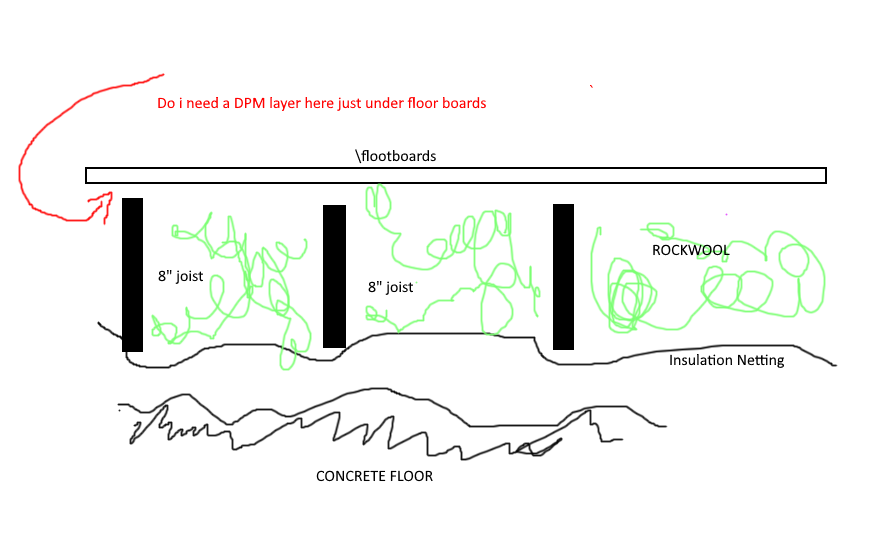

I have a ground floor , suspended timber floor with rockwool insulation between the joists. Do I need a DPM/vapour barrier between the insulation and the floorboards.
My setup is simple - hope this is enough information.
1) floorboards
2) 8" joists
3) rockwool between joists - held up with netting
4) concrete base
5) good ventilation from airbricks etc
6) ground floor
if you have good airflow with no blocked air bricks, then it should stay dry down there.
No, you don't need a DPM at the position you have indicated. Building regulations for a suspended timber floor:

Thanks for this.. i should have used the term "Vapor Barrier" its condensation i am worried about on the warm side..
Do i need a vapour barrier??
A vapour control layer is fitted on the warm side to stop warm, moisture laden air travelling to the cold side and then forming condensation.
On the floor it can go under the floorboards or it can be laid on top of the floorboards - carpet and laminate underlays often include a VCL.
A VCL is correctly taped also acts to help air tightness in the living space.
If your void is well ventilated, you may not have a problem
