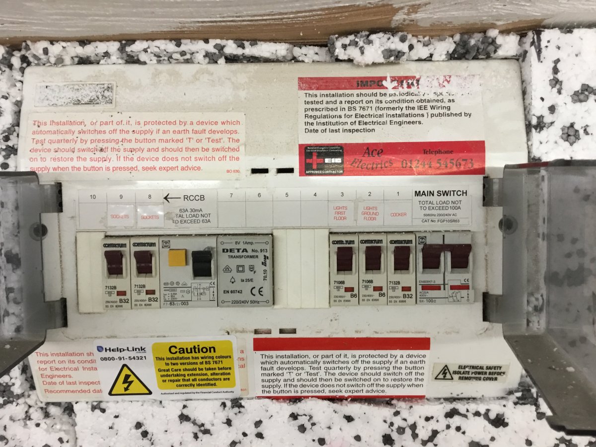

I want to hang a TV on the wall with a single socket behind it. I want to use a 13 amp fused switch supplied from a double socket, that I want to get rid of, but in order to keep the ring main intact i will need to put the 2 live wires, 2 negs and earth from the existing socket into the supply terminals of the fused switch with the load cable going to the single socket behind TV. Will this work?
That is generally how it is done, but be aware of the requirement of RCD protection for buried cable and new sockets. Do you have RCD protection on this circuit?
Thanks for your replies, the new wires will be run inside a stud wall, I am not sure about the RCD but have uploaded a pic of the consumer unit..

What you could do is: Install a FCU next to double socket, take a feed form that (only needs to be one set of cables, then a load cable to TV Socket. That would keep your double gang sockets available.
But it must be established that the circuit is not a multiple unfused spur first of a ring final.
Thanks for all your help and suggestions.
The feed to the socket i want to replace comes straight fromt the consumer unit and the out going lead goes off into the sunset, i guess it feeds other sockets before returning to the mains, I guess I can check this by switching off the mains and disconnecting the socket, and switching the mains back on to see what if any other sockets are working?
