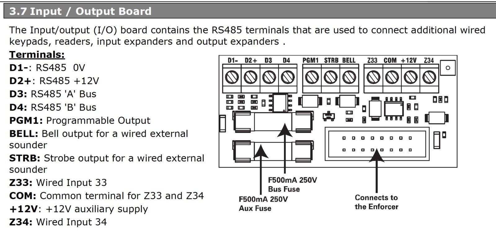

Hi,
I was hoping that someone on here could help me out.
I need to connect my enforcer to my V2 GSM module so that when the alarm goes off it rings me. So, my questions are....
1) Can I use the +12vdc and COM terminals on the enforcer I/O board to power the V2 GSM module or do I need a seperate power supply?
2) How do I get an alarm signal into the V2 GSM from the Enforcer IO board to trigger an alarm so I get a telephone message?
3) For (2) above would the BELL signal work and if so how would it be connected?
Here are the wiring details of the Enforcer IO board followed by the V2 GSM connections.
thanks in advance
Mark

Well,
Just got around to mounting my V2GSM Pyronix module and as usual with Pyronix stuff its a chew, no help from the retailer at all, what a mistake buying this crap, just like their cameras but thats another topic..
Anyway, heres what I have done...
1) Took +12VDC and the Com from the Enforcer output board (see drawing 3.7 upper drawing) and connected to the V2GSM to power it up (see 3.7 above lower drawing) Is this correct for powering up the device???
2) Took a single wire from Enforcer output board BELL terminal and connected to IN1 terminal on the V2GSM. I also wired out the PGM signal on another core, more on this later. Is this correct to get an alarm signal into the V2GSM?
3) From the the "CHANGE OUTPUTS" menu in the Enforcer I configured the "ENDSTATIONS" as follows for BELL O/P = ANY SIREN and the PGM O/P = ANY SIREN. Is this correct??

If the display is like that ....then it ain't going to dial ....try taking the supply from the data bus d+ and d-
Does you enforcer have a connector on the back for 12v supply ( some came with a small lead to attach to this connector

Hi all,
Well, I tried the D+, and the D- as recommended and the panel sprang to life. Set it up as per the book and it all works. So thanks to all who helped.
Just some notes if anyone else gets stuck...
1) The supply is connected to the +12V/)0V as shown in my previous posts.
2) Bell and Stobe from the Enforcer Panel go "low" when system in alarm. When no alarm present they go "high" and measure around 13vdc.
3) Also you do need to configure the "Endstations" as I mentioned in a previous post.
cheers and thanks to all again.
