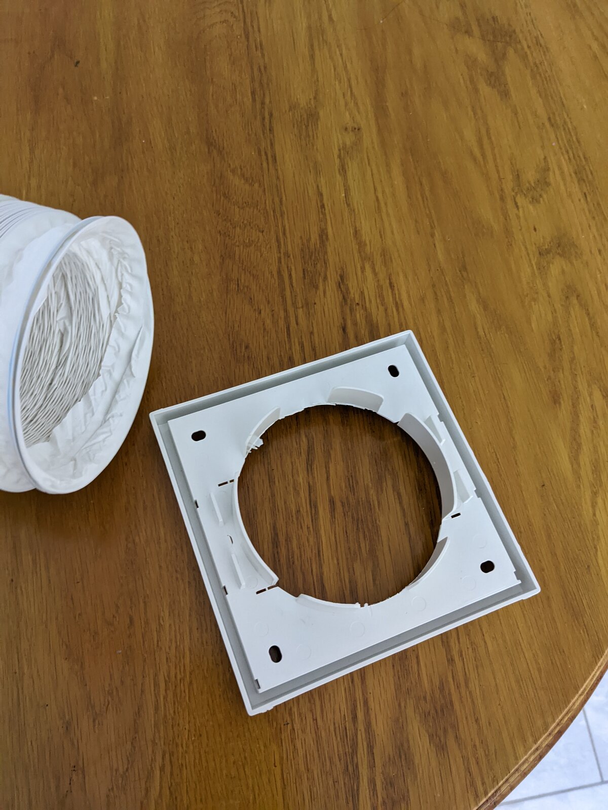

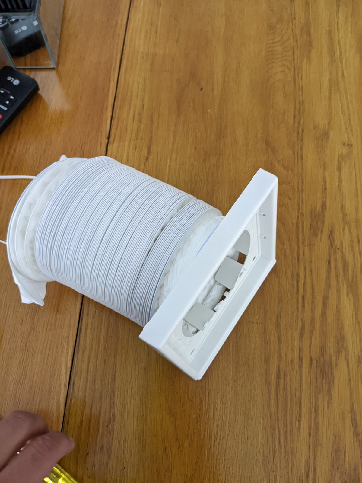

Hi sorry for the basic question having a problem connecting the 100mm Flexi duct securely to a 100mm vent.
The vent goes over fine over the outlet , I have secured with a jubilee clip and tried a zip tie but find it pulls off easily.
Thinking I might try some gorilla glue. Any tips to secure them together.

The vent you have is designed to fit on a length of rigid pipe.
If you can find a short offcut of pipe (try a local skip! ;) ), the jubilee clip should hold the Flexi to the pipe. There are also rigid to flexi adapters available.
Is this an interior vent, or one going through a wall? If it was going through the wall, I would go for rigid pipe anyway.
Thanks for the replies.
I figured it was for rigid pipe and ended up getting a round fixed spigot from Wickes.
All sorted now with a good zip tie and gorilla glue for good measure.
Hopefully won't need to change them for a while :)
