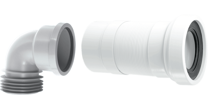

Hi all,
Seeking advice on what components I will need to connect up a new toilet to the waste. Everything is in place, just wanting to know which connectors I need. Here is the top and side views with measurements:
I thought I'd need something like:
Which is a 90 Bend Drain Connector + Plain End Outlet Straight Flexible WC Connector. Would this work? I suspect the drain connector wouldn't be high enough?
Have a look at McAlpine 90 degree pan connectors or Multikwik
