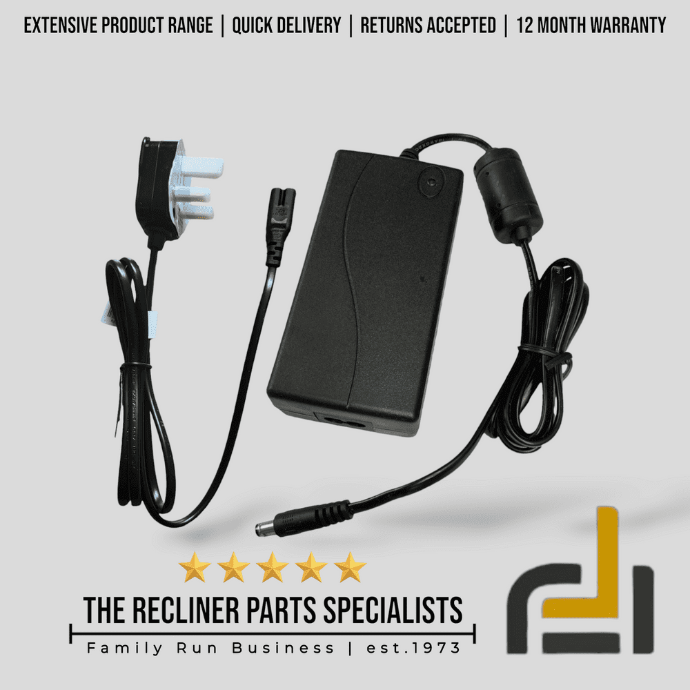

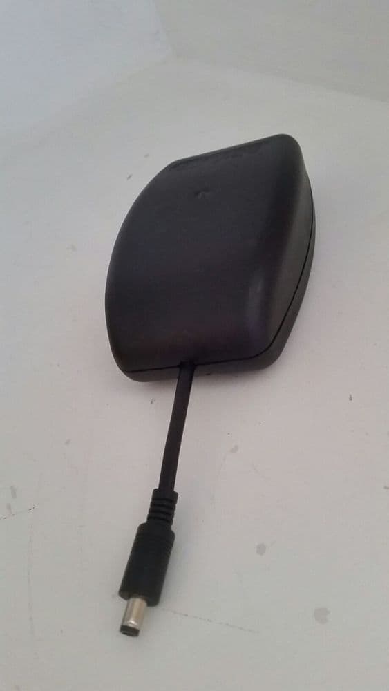

I have had a recliner diagnosed as having the 'transformer' (29v 2A) go u/s. It's an oldish suite, so happy to have a go myself. The problem: my transformer uses a round connector like lots of laptops have, and the replacements (cheapies) all have 'flat and a pin' connectors.
I have a good imagination, so I'm picturing a short adaptor to make my problem go away! Does such a thing exist? Where?

None that I have seen (or at least there are some, but there are so many types of round connector and flat and a pin' connectors that it is near impossible to match.
Also you need a good connection when you have 29V 2A - so do not want a loose connector.
So agree with your suggestion that you cut off a good length of wire and the round connector from the broken 'transformer' and cutoff the 'flat and a pin' connector and replace with the original round connector.
Also: Is your transformer 'AC' or DC 29V - send us an image of its label and its connector.
What replacements (cheapies) are you looking at - send us links - we might be Abel to suggest better ones.

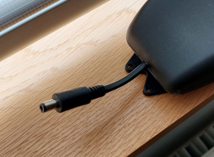

Mine has this, the others seem to have ones looking like your pic.
If you get a new power supply with a 2 pin din speaker plug connection (which is what the two pin plugs actually are) then you could fit this
to the cable from the chair instead of cutting off the old short lead etc
