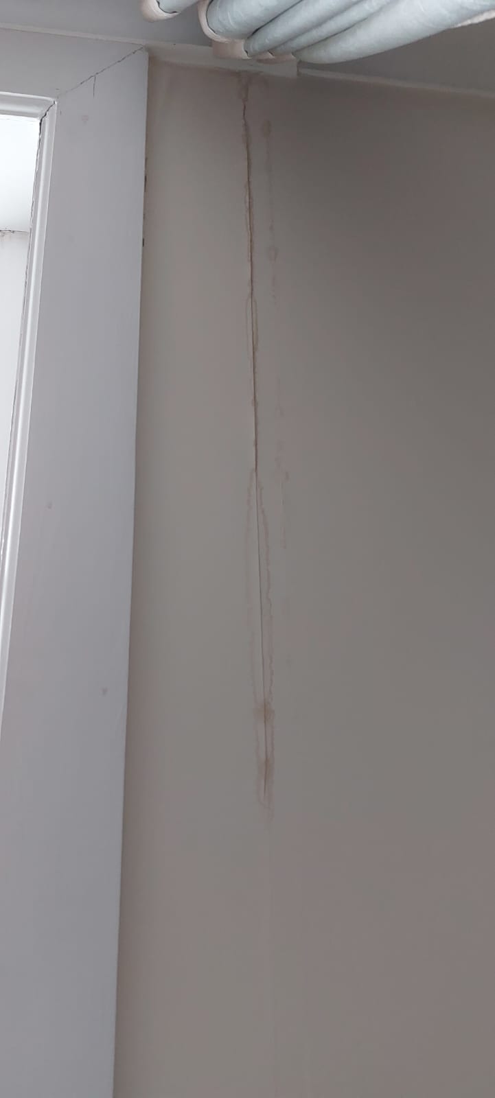

We've recently noticed that water has at some point tracked down a join in plasterboard a few cm from the door on the lounge wall. If it continues it will get to a light switch. This could have gone unnoticed for some time as it's behind a curtain.

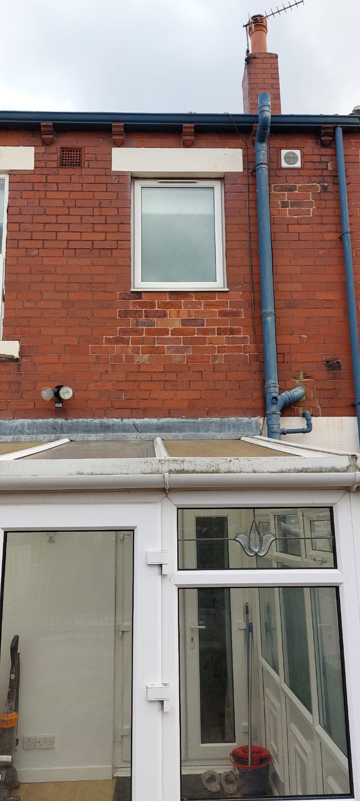

Finally got some photos
There's some vegetation visible in the guttering

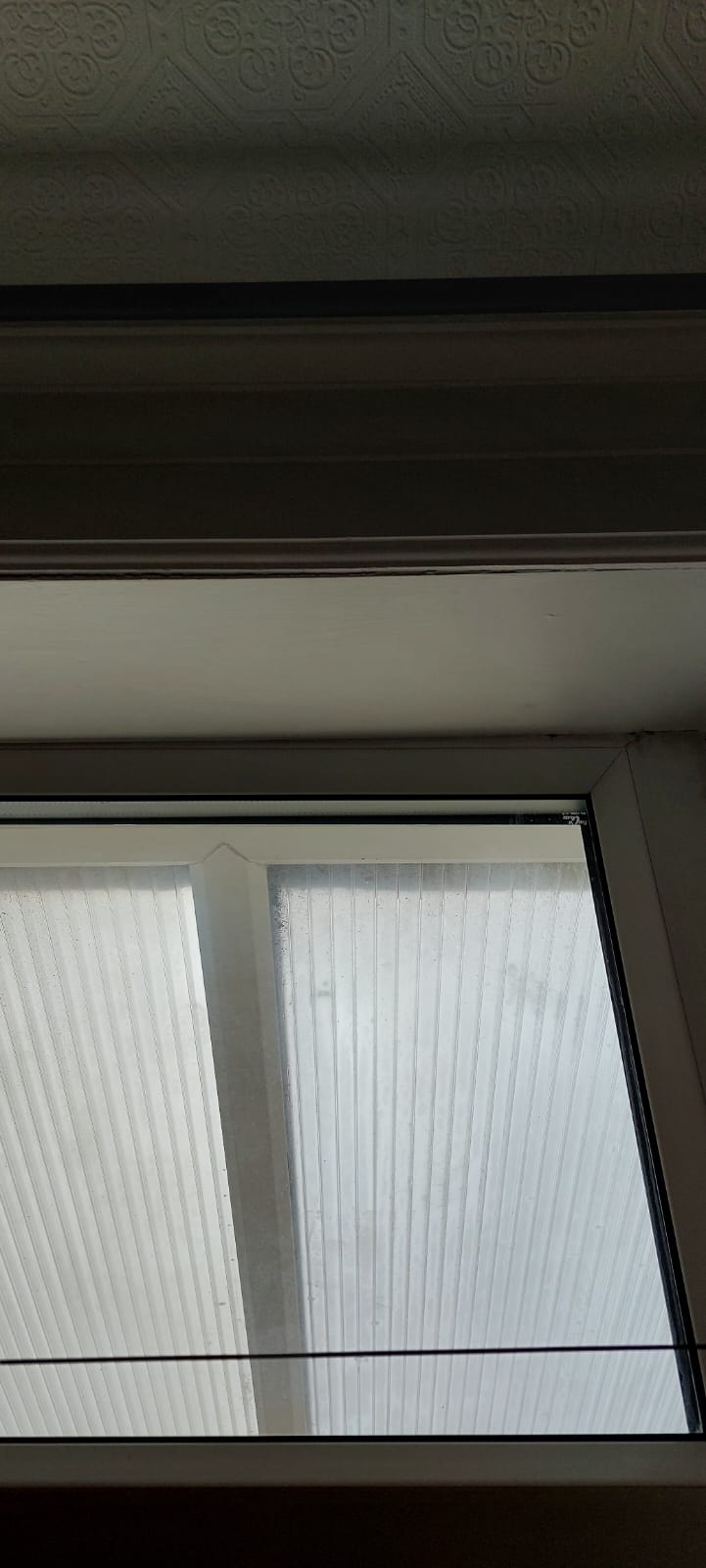

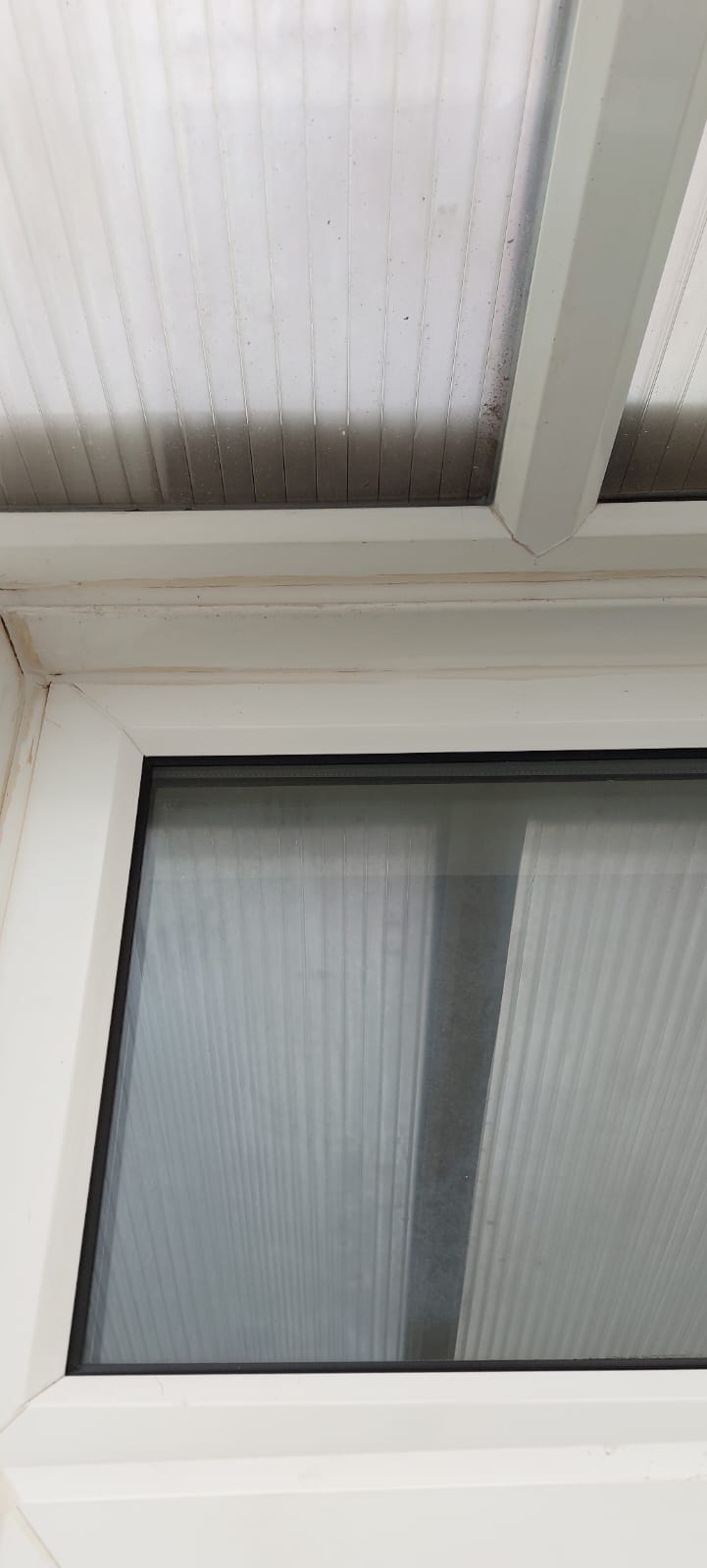

above the door inside the conservatory
above the door inside the lounge
As others have said, perhaps start with the window above. Can already see some work in the area judging by the difference in pointing
Window frames are designed to accept water getting into them, and they have drains in either the face or the base to let it out again. Ideally this water would drain onto or into the sill and flow to the edge of the sill furthest from the window before dripping off onto the below (conservatory roof in your case). If the drains are blocked the water would be finding an alternative way out, which could be e.g out of the sides of the sill and into the cavity
The brickwork looks to be common bonded too, not that you'd change it, which provides increased opportunity for water to track from an outer leaf to an inner leaf
