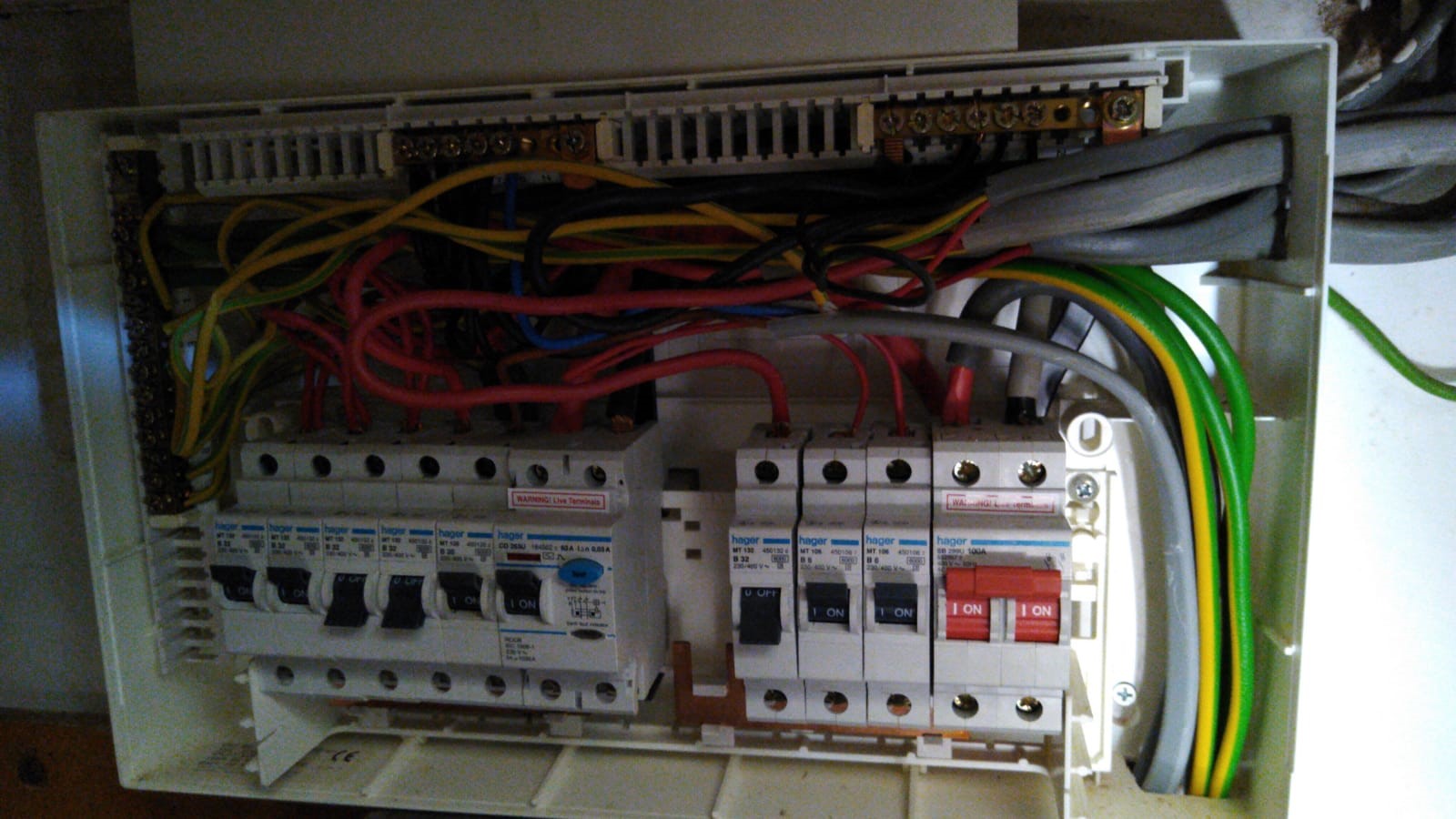

Hi
I'm installing a new hob and want to connect it to its own RCD in the CU. The only spare space in the CU is on the right side where all the lights are. Can I put in a 32amp RCD in that space?

Yeah you're right, sorry. I mean that there's a space for an MCB (if that's the correct term) on the set of switches on the right of the CU, all of which have an RCD
Here's a pic

Fitting an Mcb in there will not be rcd protected. Does it really matter? Not really.
You could fit a Hager rcbo 32A in there to meet requirements
What is that switched off 32A MCB to the right of the space for?
It was an electric shower but that's coming out actually. We're hoping to put the hob in there instead, I was asking if it's ok to do that, you know, given that the others on that side are lighting. It already seemed odd to me to have a big shower connected there. So if I take that out, is it ok to have a hob there instead on a 32MCB?
It would be alright.
What is the switched off 32A MCB fourth from the left for?
What I am getting at is - do you not already have a 'cooker' circuit?
Good question, it doesn't appear to be connected to anything! So we can use that space, but we were planning to run a separate new feed for the boiler from there.

So question seems to have been answered, a RBCO would satisfy IET/BSi requirement for additions to a circuit but a MCB can only be used if no new buried wiring or sockets are added, so in real terms can't use a MCB on the non RCD protected side of the consumer unit it must be a RCBO, an oven would need a type AC but an induction hob may need a type A but to be frank I have not fitted a type A, and it is unclear if breaking any rules fitting type AC plus in my case type A are not available for my board, and it was not until a lot latter I thought about which type had been fitted, and I do wonder does it really matter? I have seen one boiler with instructions which say use type A not seen any other domestic appliance which stipulates the type. Only car charging points seem to stipulate the RCD type.
