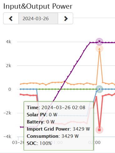

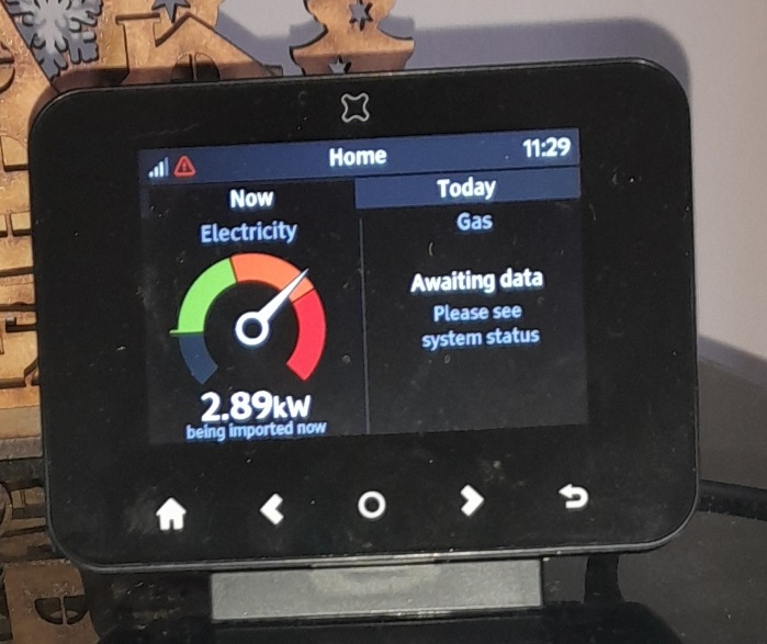

I am not sure if both solar and battery can be used together, but noted the smart meter in house display Shower power use with full battery and sun2.jpg while daughter taking a shower, and the shower is not 2.98 kW, so a far whack was being delivered by solar and battery.
There was a time when we saw 63 amp RCD's being fitted in consumer units (CU) which were supplied by a 100 amp fuse, and had MCB's on each RCD which exceeded the 63 amp, it has now been made clear that is not permitted, clearly since some people still have 60 amp supplies there is nothing wrong in selling CU with 63 amp RCD's, but some one needs to sign that they have designed the installation, and it is up to them how they go about it.
I would think today most EV chargers have the 6 mA DC detection built in, so type A RCBO's are OK. However one can't take this for granted, and not seen a single module width RCBO which is type B, although mine did say type B on the packet, after they were fitted found they were type AC curve B. My fault never opened the packets, the guy just fitted what I had provided, which is a lesson to be learnt, let the electrician doing the work select the materials.
I look at both smart meter and solar panel display and both show the max demand, this 1711448468452.png is normal rare I use more than 4 kW except for when having a shower, but the peak was at 2 am when one would expect to be charging a car. Had my wife made coffee just ½ hour earlier then likely over 5 kW load. One would hope the EV charger is monitoring the total power being used, and auto reduce charge rate, but this depends what charger is fitted.
