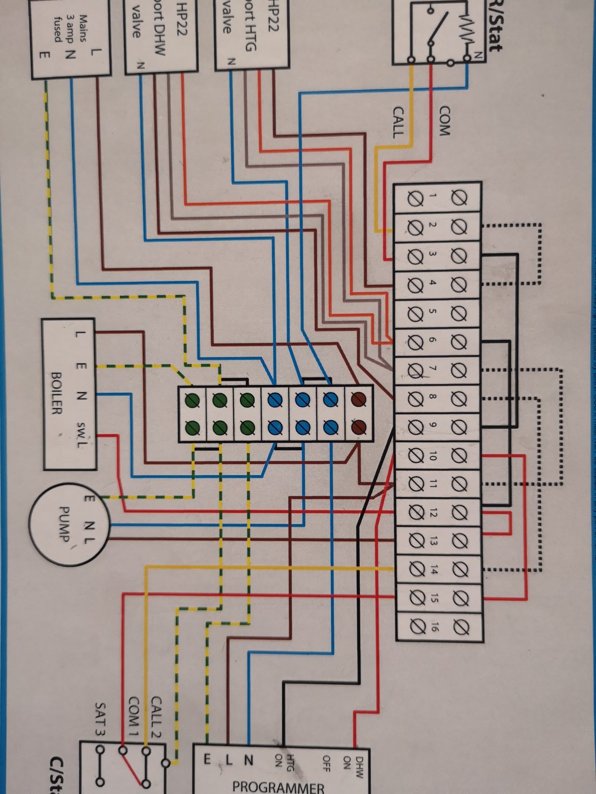

Hi all.
Not a heating engineer my boiler has no switch live. Earth/Neutral no issues with that one. My question is do I connect it to permeant live in box or as per the diagram inside lid which says It has to go into the terminal for the SWL but my Schematic says it should go into permanent live. Picture attached

I would say sw L goes to L on your boiler and it is L that does not exist in your case.
When there is no run on with the boiler (no sw L) often it needs the DHW connected at all times using thermo syphon so the is some where for the heat to go, I have same with my oil boiler, and was advised not to fit a motorised valve or pump to DHW.
My daughters old house had a gas boiler with simple on/off and no run on, however it was on a Y Plan which means the default position for the motorised valve is DHW, the pump stopped with the boiler, but pumps do not stop the water flow, it is clearly reduced when pump is stopped, but can still flow.
Maybe best to ask modulators to move post to plumbing section, and also state what boiler, I would assume oil, as hard to get a gas boiler which does not modulate.
