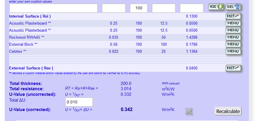

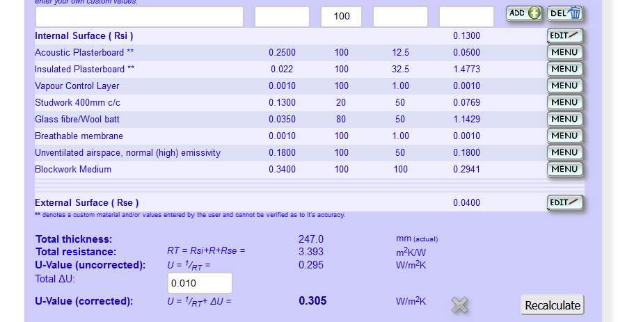

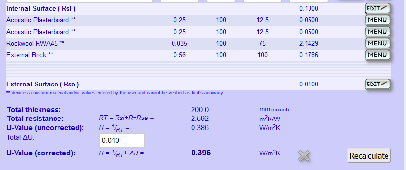

I am a bit confused on how I should be going about this. The current size is 5.27m * 2.50m, I want to keep as much of the width as possible.
I am looking into converting it myself, just unsure how to maximum the noise cancellation and not loosing much width.
I will be getting the door taken off, bricked up and a window installed.
FWIW I wouldn't be listening to it loud ever, I just don't want the neighbours (5m+ away) from hearing me watch The Dark Knight trilogy at 3am
Should I use 70mm rockwool with two layers of acoustic plasterboard?
Or
50mm rockwool with 20mm insulated PIR + two layers of acoustic plasterboard
How should my layers be for both of these
100mm Brick
50mm Air Gap
DPM?
70mm rockwool
Vapour Barrier?
Plasterboard
Green Glue
Plasterboard
Skim
Paint
