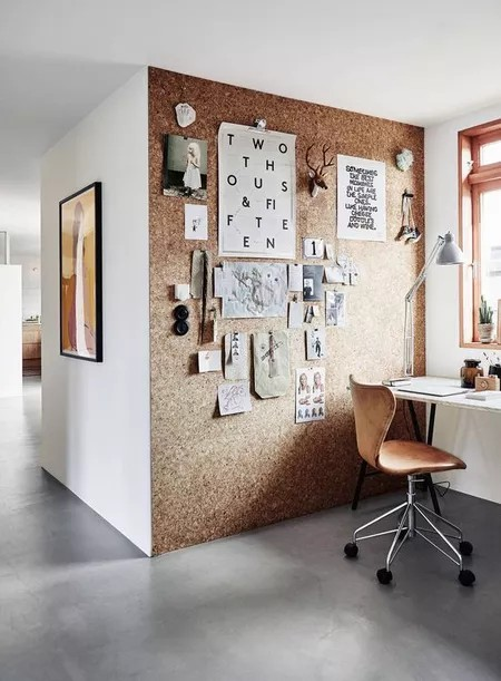

Hi,
I'm afraid this might not be much help!
Cork wall tiles seem to be 'on trend' at the moment!
You could start using it as a corkboard; pinning up pictures, a whiteboard, blackboard, post it notes etc.
It could actually be quite useful, and I'm sure the family will join in with the decoration! :)
Thanks random grinch – a nice picture!
I think we’d be open to leaving one wall as a noticeboard – but there are many many many walls!!
