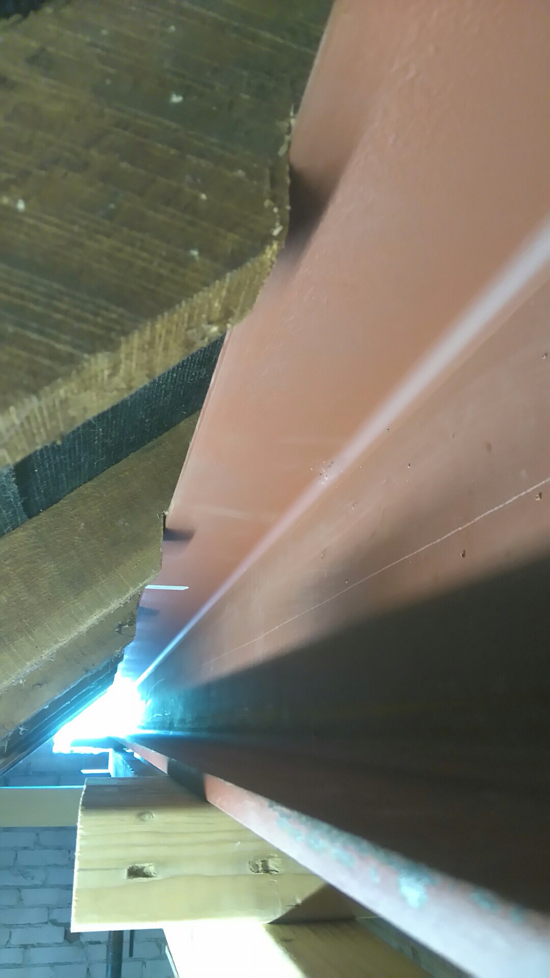

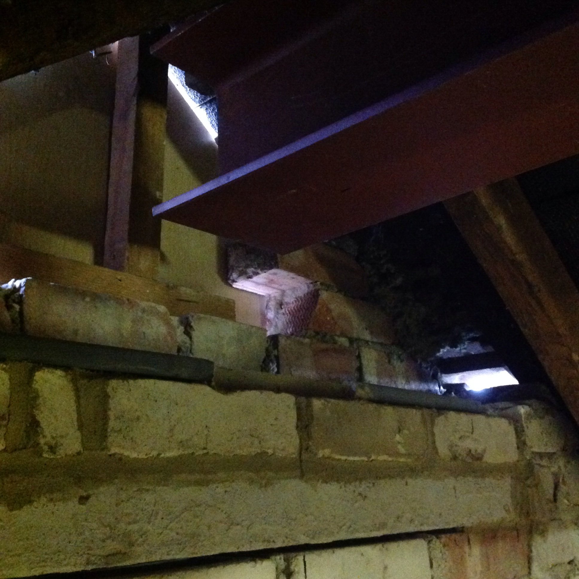

Perhaps I should start another post but as it is to do with this beam ( now installed partly) I'll leave it here for now.
Question. Should the new ridge beam sit directly on top of the 127x76 13? It seems such a small beam with only a 4mm centre yet I'm about to sit pretty much the whole roof and the new beam on it. Also what should the cement to sand ratio be for bedding the bricks below it in?
Here is the beam over the gable end wall without the smaller steel installed yet.
should the ridge beam sit directly on this small beam?
