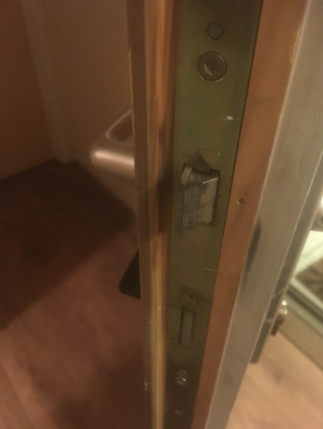

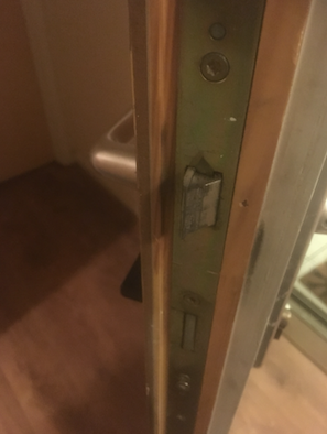

If at all possible, I would like to try and replace my front door lock myself. I reckon it's about to fail completely. The key keeps spinning about, and it takes several attempts for the key to be accepted and lock it.
I want to do it myself, as I've been hit with some large unexpected bills this month, and have a rather poor cash flow at the moment.
Do you reckon I could do this myself, and if so what sort of tools would I need? I see there is a metal reinforcing strip on the door, and am not so sure how to remove it.
Any advice appreciated. Thanks.
Should be just the barrel and not the lock strip itself,if you look down the lock strip and remove the screw That is under the lock pin(the bit that pops out under the latch when you turn your key) turn your key slightly and pull the lock from the thumb turn side it will pull out. Just need to measure the cylinder and order a new one off eBay for under a tenner, if your stuck just google diy euro cylinder replacement

Thanks, sounds promising!
Really is very simple,might need to unscrew the handle also to make it easier to put new lock in. Sort of job I can charge £60-£100 depending on the quality of the lock as I give a guarantee but costs pennies to do
