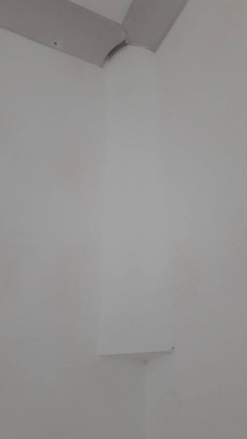

I have a room with an angled corner where the water pipe is boxed in. Please see attached. Please could anybody advise how to go about cutting the angles to ensure a smoother run of the coving?
Any suggestions greatly appreciated.

Do the wee bit with 2x22.5's on it then do the longer lengths with 22.5s on.
Or do it like skirting and cut the back off, offer the first piece up use a straight edge and mark the angle of interception, copy this to the piece to cut.
Or... you could do it properly (you'll have to flip it 180 degrees) and no... not close enough... nowhere near
