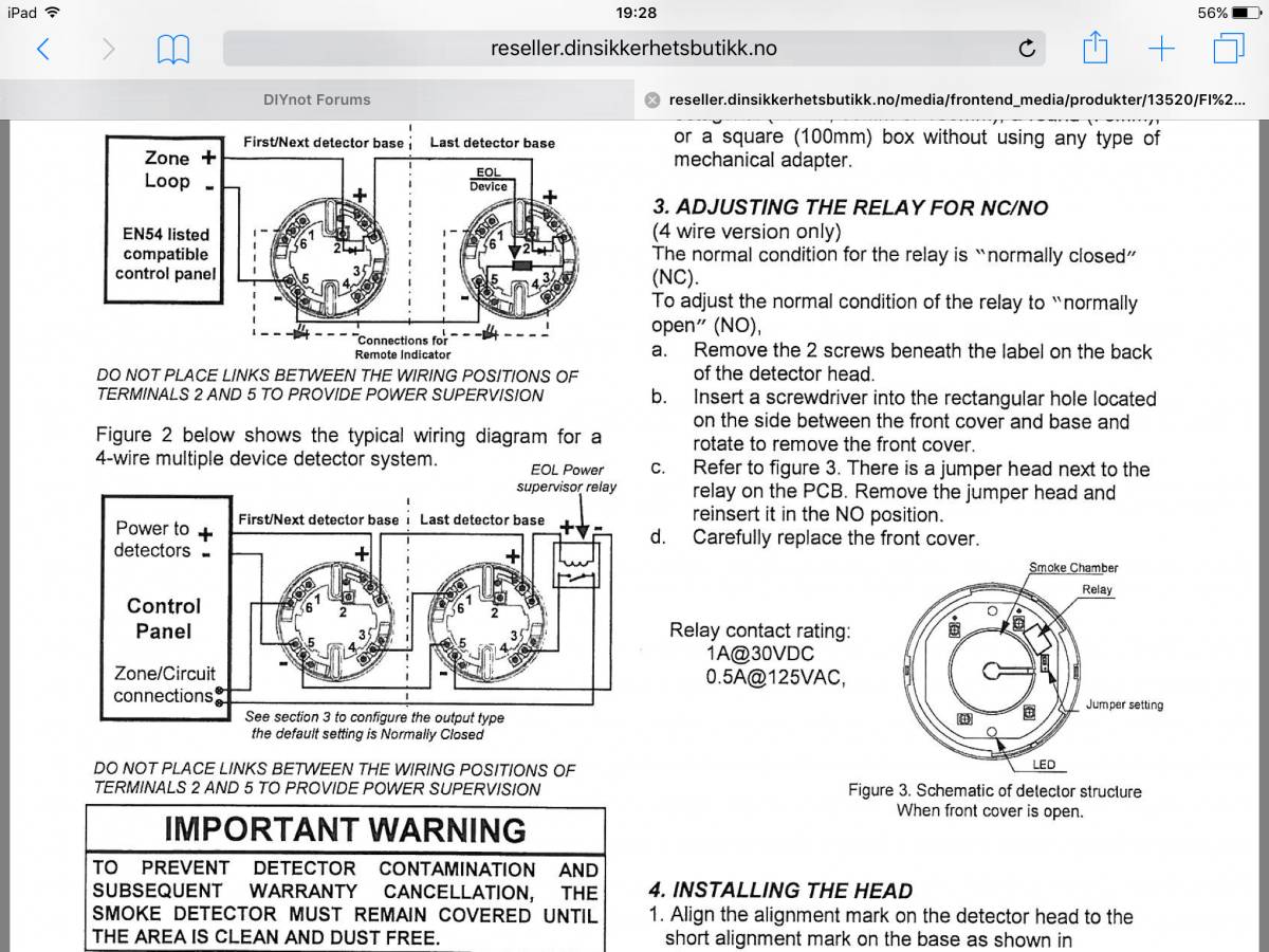

Hi,
I purchased a CQR Monoxide detector, model CQR-983-CO-12, to wire into my alarm panel.
This detector has a relay output, so I believe it should work. Unfortunately the model did not come supplied with a manual and googling has not given me any answers.
The base unit has number 2, 3, 4, 5 and 6.
The detector unit has four terminals that connect to these with the letters L, C, P and P.
- The two "P"s attach to 5 and 6 on the base.
- L to 3 and 4 on the base
- C to 2 on the base
I would be grateful if anyone can shed any light on how to wire this in to my alarm.
Many Thanks,
Arden
As it probably uses the same base as the fire detectors , see diagram
