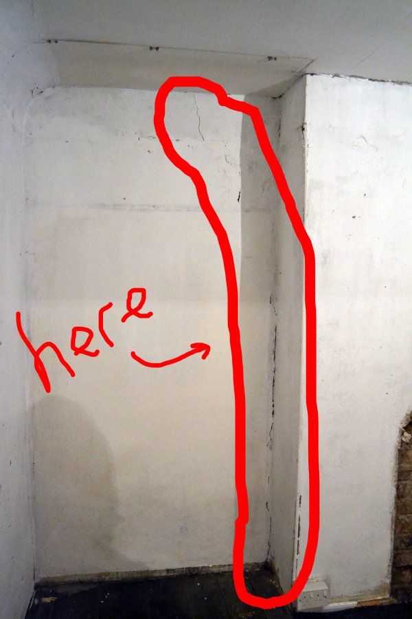

I'm fixing up and old house (1800 and something!)

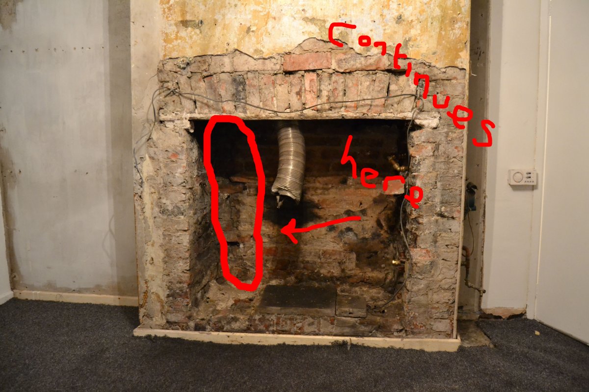

After taking off wallpaper upstairs I noticed a crack from the top of the room to the bottom. I went downstairs and removed wallpaper there and discovered the same crack continuing down the wall and through the chimney breast.

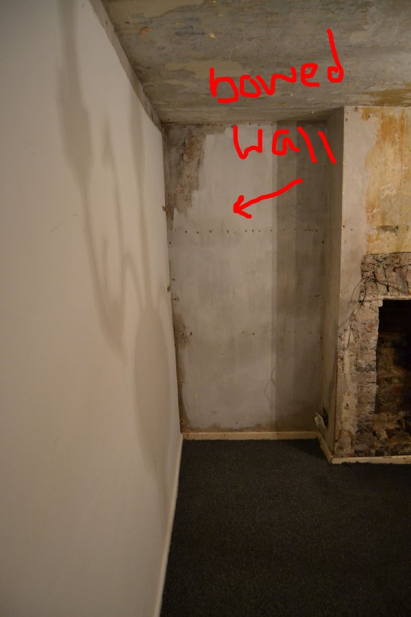

I've also now noticed the wall next to this one is bowing.
Should I be concerned?
I have attached 3 images.
White wall is upstairs showing crack going down.
Other fireplace is directly underneath the other room showing the crack continuing.
The bowed wall can be seen on the alcove image. It measure 3" more across the top of the alcove than the bottom.

Is that wall an outside wall? Why not take pics of the other side of the wall at both floor levels?
In the c/breast recess, why not remove the plaster back to brick and photo?
Have you looked up in the loft for any unusual signs?
There seems to be a number of condensation signs (dark patches) on your walls - or is it merely some wallpaper issue etc?
The upstairs backs onto an outside wall, but downstairs is built on to my neighbours garage so I cant see. Due to the position of the house however, I can't see the upstairs wall from outside. Very frustrating.
The house has had lots of black mould, that i've been told is condensation.
The house sat empty for a year before I bought it. Do you think it's something and nothing?
The upstairs wall does not bow, just the downstairs which is odd as it's the same wall.
It's nothing. A thermal crack from previous contraction.
