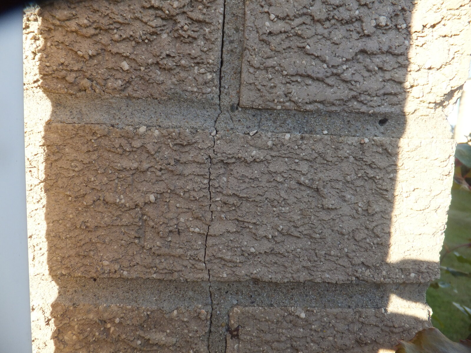

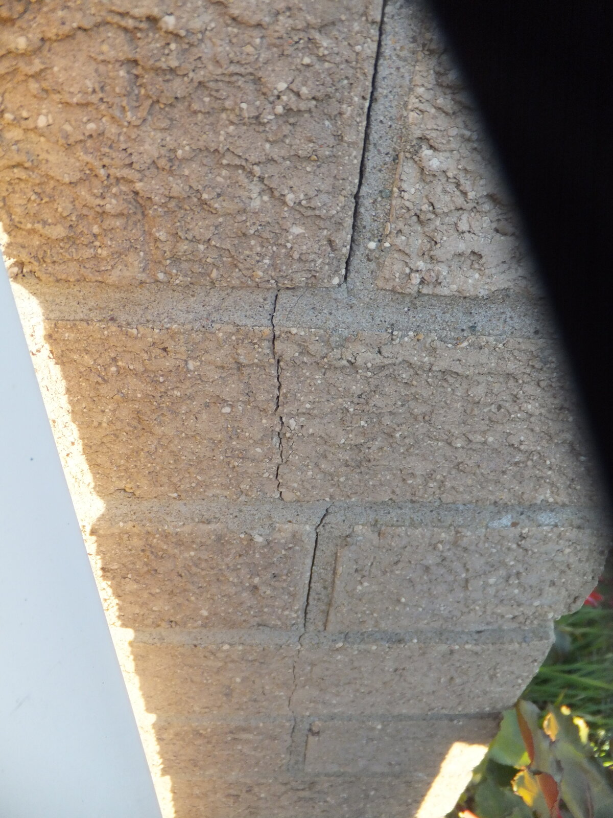

Hello Builders
I would greatly appreciate your help. I have to make a quick decision on buying a bungalow in Underwood Grove North burn Cramlington. The problem is there are cracks in the BRICKS on the corner of one wall (see attach pictures). The cracks stop at second course of bricks from the bottom of the wall. The adjacent wall has some very small local cracks in the mortar but not in the bricks.
Thermal contraction. Will require some work but should not in itself put you off buying.
Hi Woody
Thank you for your reply. Can I please ask what is thermal contraction and what remedial work would you suggest.
Rapid shrinking from being wet and then heating up and drying. The mortar is flexible but the bricks not so, so they crack like that. The repair, may require an expansion joint being formed to prevent the same thing happening again.
Actual remedial work should be specified by a structural engineer, not a builder.

Your engineer should be specifying a repair, and if you're lucky the building surveyor will tell you the likely cause.
The location of the wall in terms of weathering it receives has the largest influence in thermal cracking.

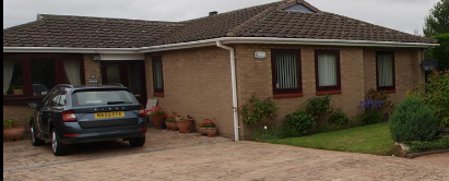

A photo about 10ft further back would have been more beneficial, fortunately Woody can see the wider picture;-)
As above, the context is important.
Is the corner in question one where the 10ft wall meets a longer wall?
Thank you for your help. I have attached a picture of the wall, the crack is very close to the down pipe on the right hand side of it.
