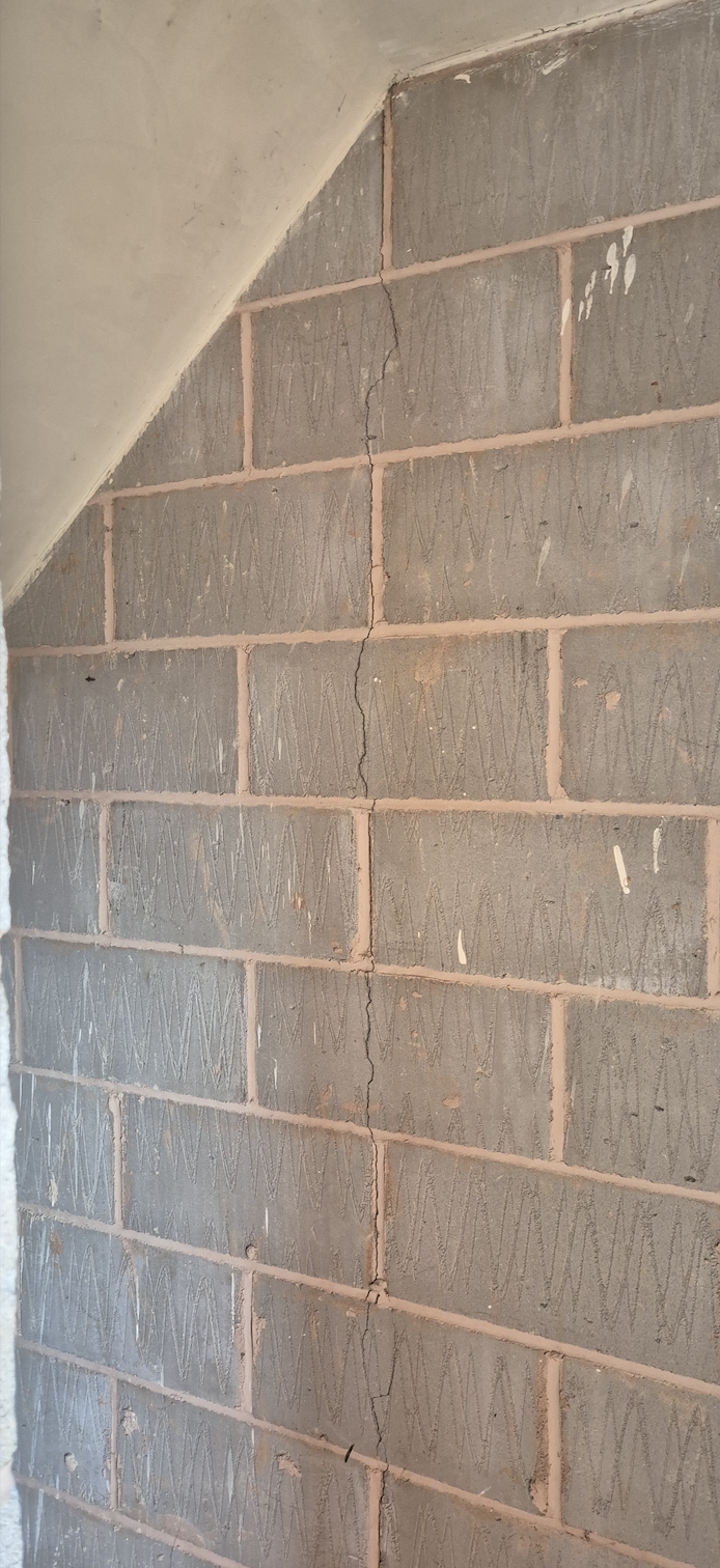

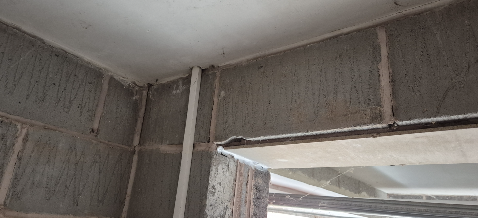

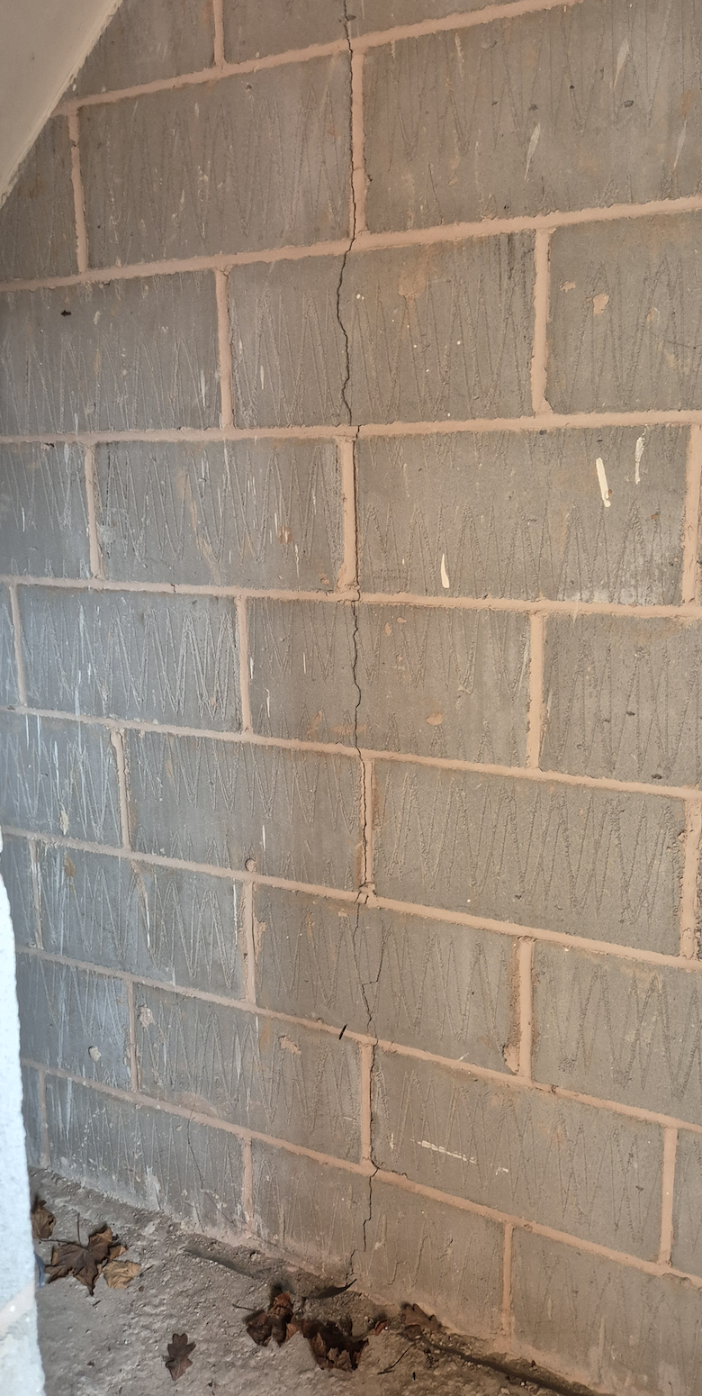

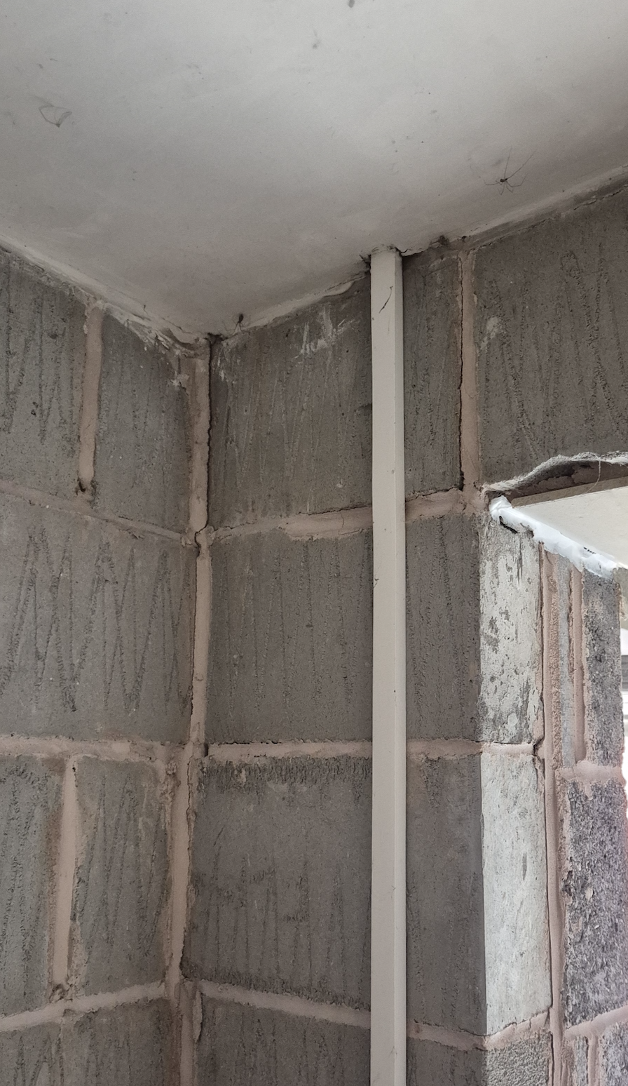

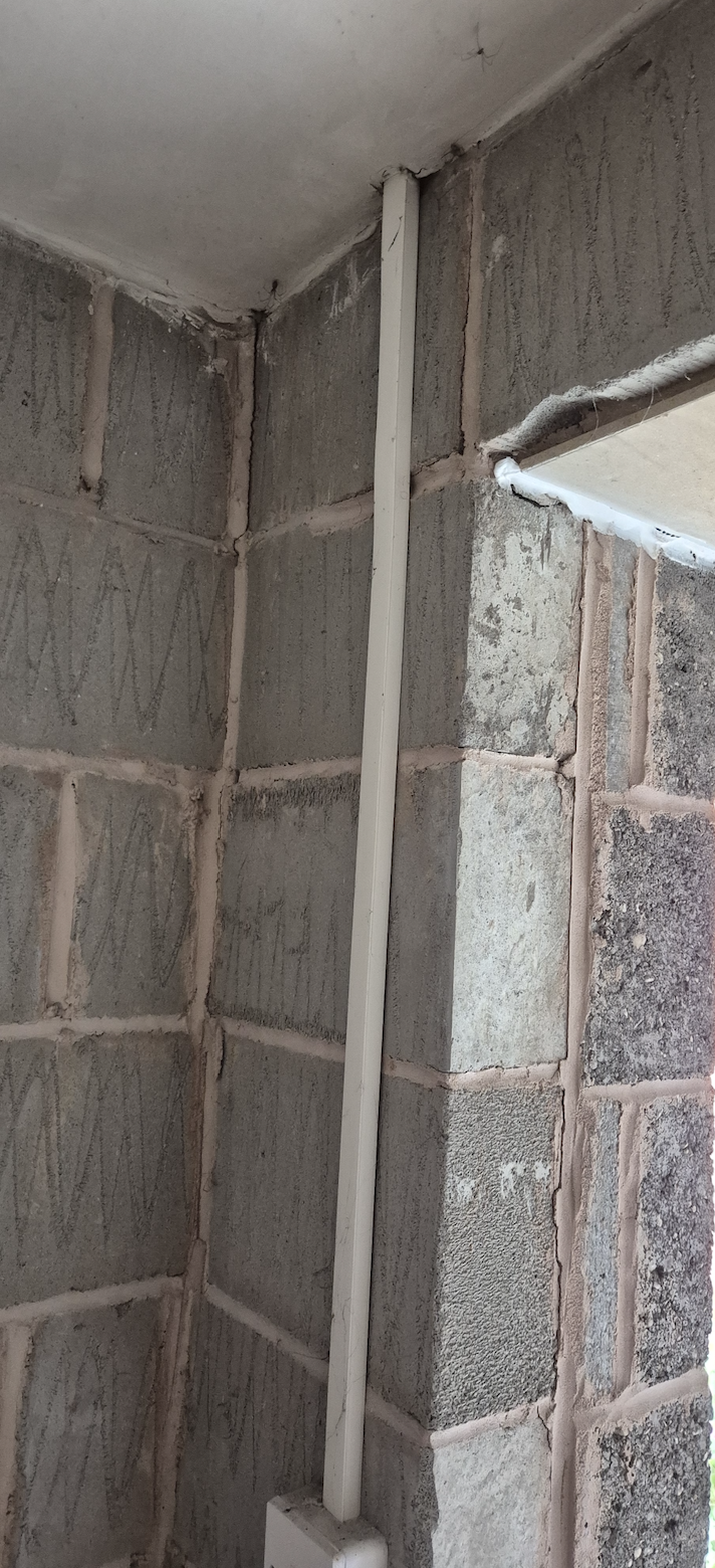

I have some cracks in the internal breeze blocks in the garage below a flat, which is on top of two garage blocks (with a gap in the middle for pedestrian access). There are no cracks on the external brickwork which appears to be in good condition.
The garages and flat were built in approx 2000.
Is this anything to worry about? I've not had a survey done.
Thank you

It’s common for those blocks to have shrinkage vertical cracks like that. Not an issue
