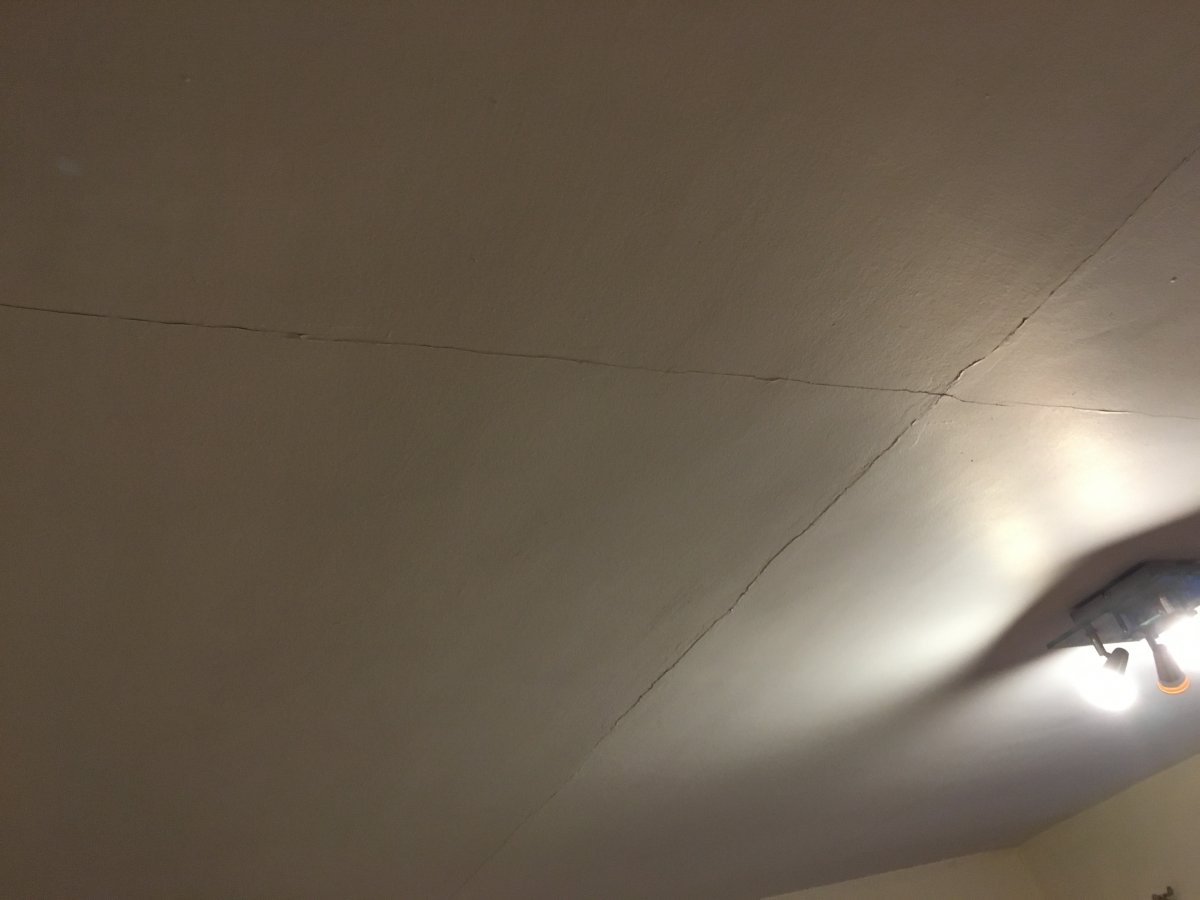

Cracks in plasterboard
8 Sep 2012
833
11
West Midlands
i noticed a few cracks(looks like near plasterboard joints). What's the best solution to fix and stop this happening in future. Keen to get a good solution
I don't know if you'll succeed in stopping it for the future, but raking them out a bit wider then filling hem in will help mask them now. What's above the ceiling? I suspect it's flexing, coupled with there being no scrim tape on the joints means you'll always run the risk of this, even with flexible fillers
