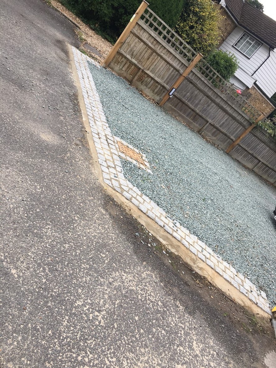

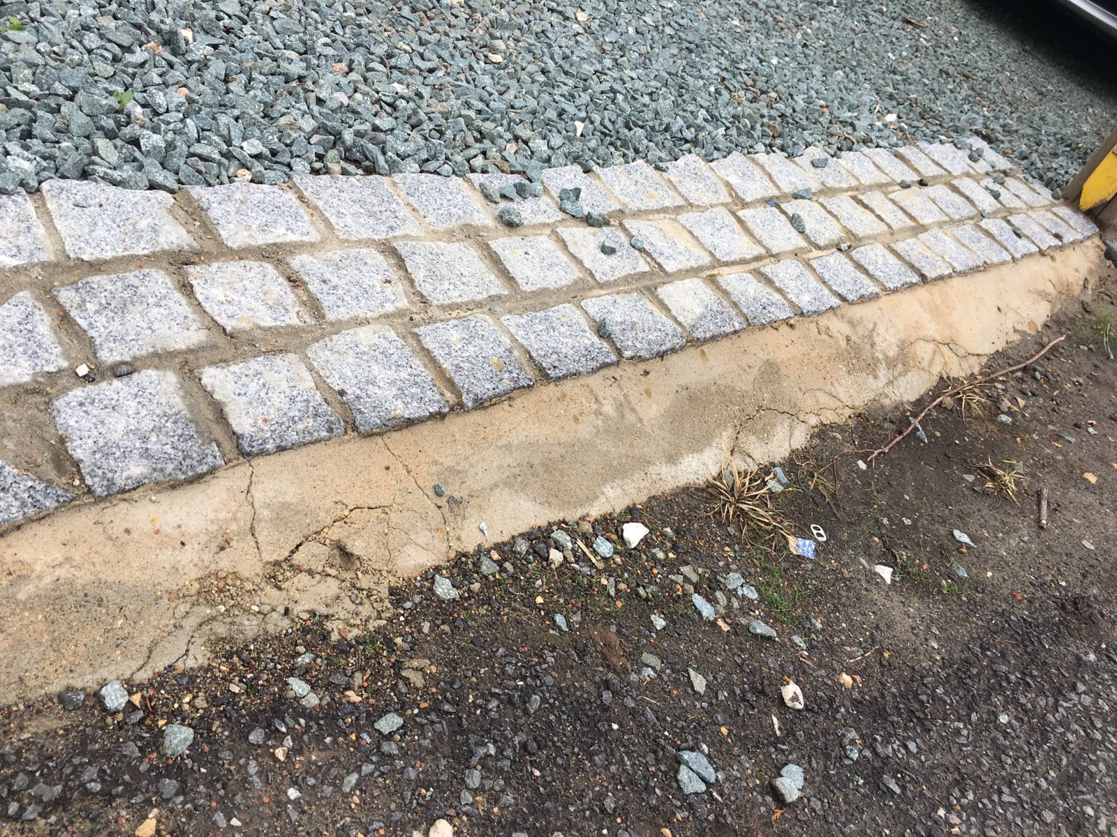

I used a highly recommended guy (recomended by a builder friend) to do some work for me but it is cracking after just a few months, absolutely gutted
How bad do these look - am I overeacting being really concerned by it?
Are they repairable by the looks of things?
Driveway edging:

Could this be caused by heave (we are in a high clay area) which has actually caused some cracks to appear in our lawn during the very hot weather?
I am assuming this is just going to get worse and worse and fall apart? Or am I overeacting
Or, if it was caused by heave can I just try to chop out & repoint the cracked mortar and hope we don't have another heatwave
It was all only done 5 months ago

The first pic shows the edging being a skim down to nothing so that would crack. You could dig it out square (downwards) to get a thicker lump of concrete in there or tarmac upto the cobbles.
Thanks... This is an overview picture - the tarmac is missing / in poor shape where the edge is as you can see

There is no indication of "heave" as an aside to this i work as a Subsidence engineer, have done so for a few years, at one meeting of about 15 Engineers we were asked if anyone had ever seen the dreaded "heave" no one had, but in discussion Heave only occurs under exceptionally unusual conditions where a "load" has recently been removed from an area of ground, the exposed ground then reforms and rises, hence "heave"
As for the cracks in the cement front edging to the blocks, it is simply not strong enough, it should have been Concrete, and that should have been taken down 300 / 400. mm plus reinforcement to withstand the sliding force of the blocks pushing down slope on to it. Actually my preference would have been to install a Granite Kerb fully backed by concrete haunching? The cement is weak, and transferring movement from the driveway on to the even softer tar mac
The cracked mortar in the brickwork could be down to the recent hot weather or a over strong mortar?
