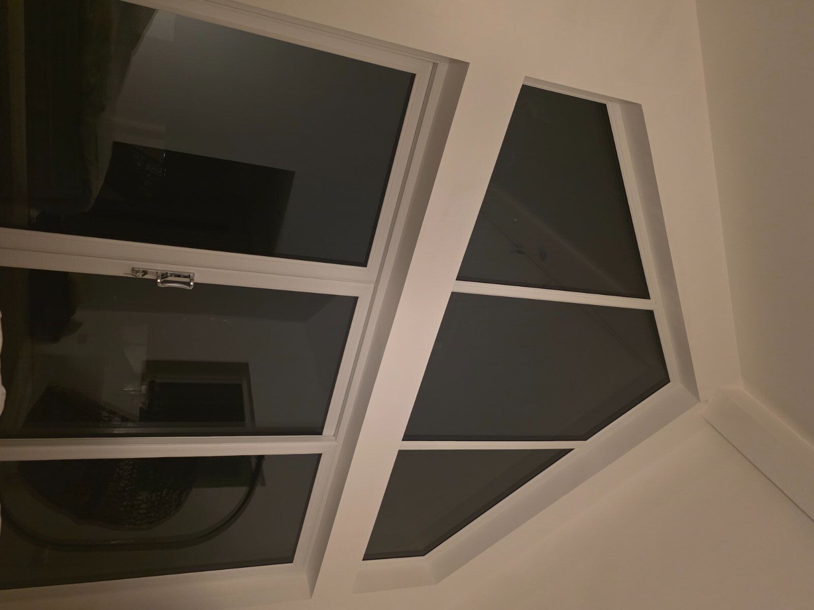

Hi everyone,
Just moved into a house, in our main bedroom we have double glazed upvc door and lots of windows as seen in photo. In high wind the door in the centre creaks and the glass moves and shakes as though someone is pushing on it like the pressure is really strong and it is flexing almost. I have a video but can't seem to upload it. Does this sound normal for this type of window and door?
It sounds like it's going to cave in and i am struggling to sleep in there when it's windy because I'm so worried it's going to come in. Thanks in advance.

Is this ground floor or first floor? Guessing first and also guessing that the wind can hit it fairly unobstructed ( eg across fields and no trees or buildings in the way? ) , then unfortunately with that type of product , yes the creaking and the glass movement would be expected. The pvc is not 100% rigid as wood or aluminium would be . The glass will bend/bow a fair bit before it even thinks it of letting go ( fun fact if you had a big enough piece of toughened glass you could bend it to so both ends meet).
If my suspicions about the location are correct then , if it was me specing that , I would have said Aluminium and potentially 6mm thick toughened glass, as in the location of high up and unobstructed wind , upvc and 4mm Tough glass will always flex
This has put my mind at ease a fair bit!! It is first floor and yes getting a lot of wind as we are on in the sticks! Thank you so much X
