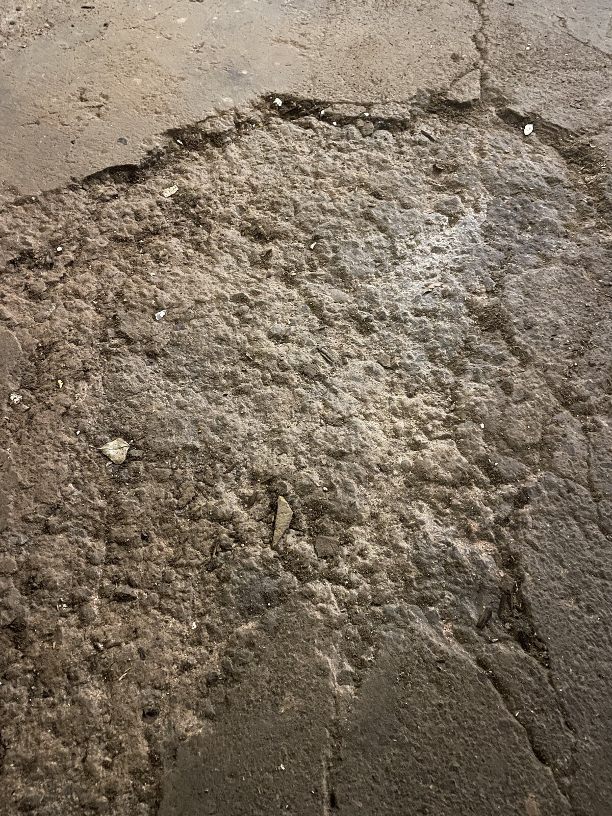

Over the past few years the floor in garage have eroded Away not sure why but want to patch it up without replacing the whole floor. What can I use to repair solidly that won’t crack easily? Thanks

ultra crete m90 rapid . mix with some sbr and sbr the floor before laying.... looks like a weak concrete floor though so youll always have problems.
Thanks - will thin areas crack when the hole is filled?
sorry , didn’t see your picture last night. that’s really thin , maybe a leveller would be more suitable. are you driving over it?
