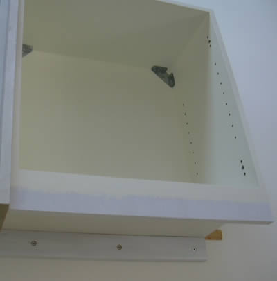

Right,I think I've got what you mean,
Like you say cut 3" off at the back of the unit so the front will looks the same as the rest of the unit.Best to cut it first before putting the unit together then you might have to pin the backing sheet onto the back instead of slotting it into the groove type (if any,might disappear after cutting)depending on what type of units you have.
You might have to use corner bracket fitting as in the picture if you're fitting it to the wall and also have a look at this useful website to help you to fit your kitchen,see this. Look at the kitchen DIY section.

The reason was,if you cut the height you will hit the fitting that hold the unit together,so it's easier to cut the back of the unit and you may or not just loose the fitting at the back but if you do that why I suggested using the angle bracket as it will hold the unit together plus fixing to the wall.Another bonus cutting the back of the unit is,if you didn't cut a perfect line,it won't noticed as it will be hidden. :wink:
