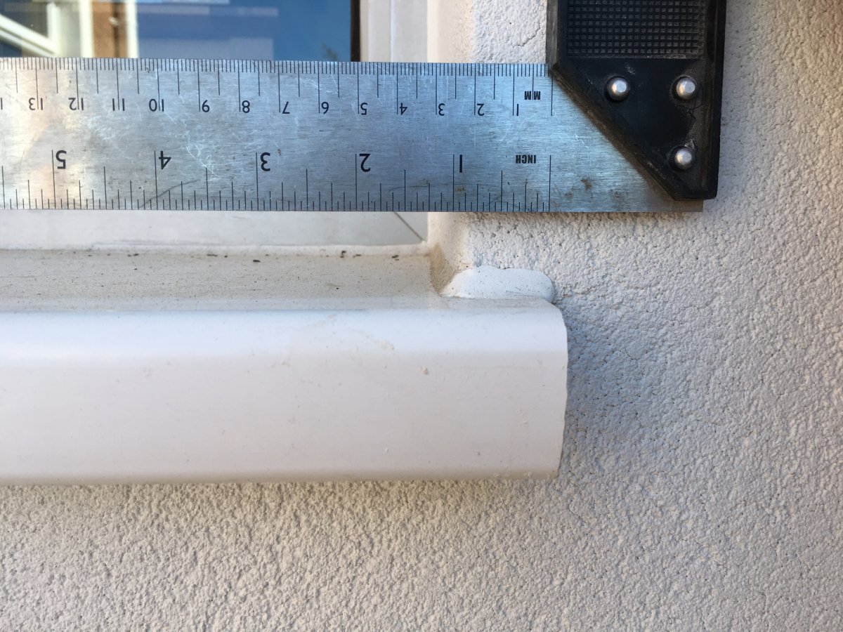

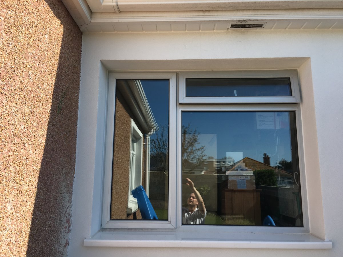

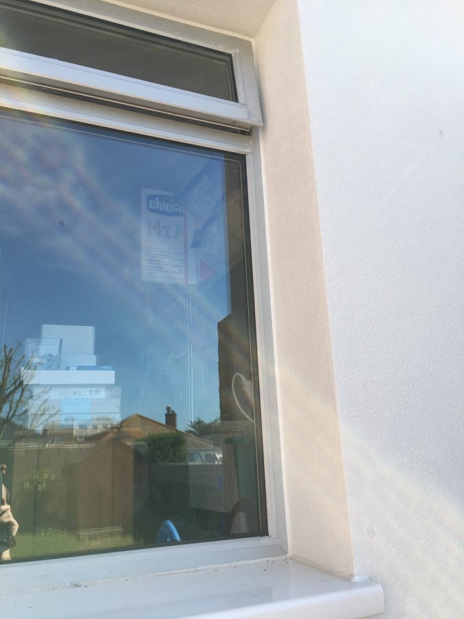

- Insulation is 90mm thick (less in the reveals as shown)
- Boards were Kay-Cel, base coat I am unsure of the make (It was French), and the top coat was Parex 534 Sand Fine
Hopefully the photos help. The ideal solution in terms of biggest windows is to cut back to where the sills (They are fascias) are, and re-form the corner there. Can this not be done without a bead? I thought as the render would have some strength, it could be rendered up to as the new corner? This could be nonsense, but would be good to know why.
The other method sounds a lot easier and probably what I will end up doing. I have some round carbide tipped cutters for my Fein tool, and can cut 100mm back from the front edge carefully, and then the window can get slotted in via the inside - the reveal inside will need re-plastering anyway so any damage past the bead would not matter.
Before I go for the easy option, I would want to rule out the harder but ideal option, or it would forever bug me that I'd been lazy.

I'm going to stop and pause a minute Tim. Having gone back over the post, I now see that part of wanting to move the windows outwards, is to reduce the cold bridge, but how bad is it; do you have any cold spots around the windows, and have you put an IR themometer on them to compare the difference.
If you're happy to replace the windows to their current position, and can carefully extract them from inside wthout damaging the EWI, then unless the cold bridge is bad, I'd be temped to replace as is. But even if you were to move them further out, I still wouldn't go as far as the edge, because as Vinn has pointed out, you risk a weak join between the window and the insulation that may not have been fixed securely to the wall. And you don't know how they fixed the reveal insulation to the wall, and you could well find that you've got a thin strip floating about. You might get away with fixing to the edge if you were to superglue a trim to the window frame, and then silicone it to the EWI, but it's a bit of a risk.
And I'd consider this to be the sensible method, not the lazy one.
