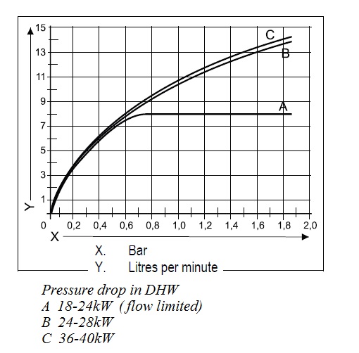

What about pressure drop ( which is flow rate dependent ) through the combi heat exchanger without a matching reduction on the cold supply ?
