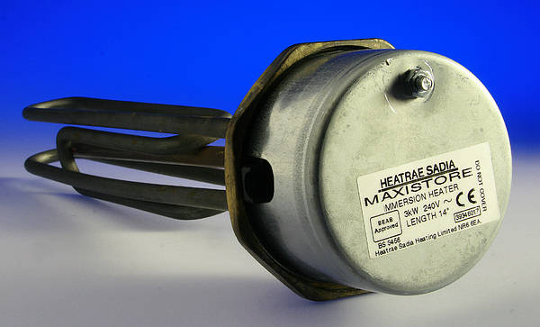

Thanks for comments- the reason I ask about draining the cylinder is the stat looks unlike the ones on eg screwfix website - it has two wires coming out the end, seems to be moveable in and out and of a hole in the cylinder witha nut on the end - I think it is a combimation cylinder - we have no cold water or F+E cistern

Maybe the thing you're looking at is the immersion heater element - it screws into a large boss in the cylinder.
Here's one:
You have to drain the cylinder to replace the above component.

It doesn't matter. Either you have an immersion heater or you don't. If you have a combination cylinder then it just means that you can't have a top-mounted IH.
One remote possibility is that you have one of those weird low voltage elements. Does it look like this:

it looks to me like a dry component, not a wet one.
Is that a screw in the side of the big nut?
I so, does removal of that screw allow withdrawal of the thermostat/thermocouple?
Yes, undo the screw and the thermostat phial will pull out. By the way, why do you think it is faulty?
