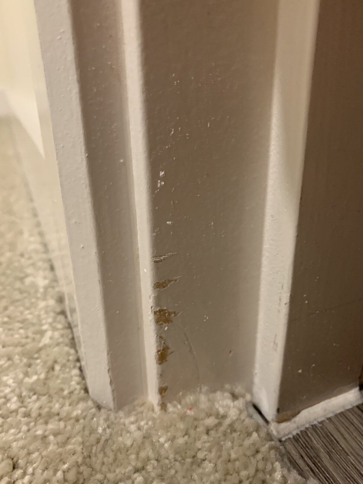

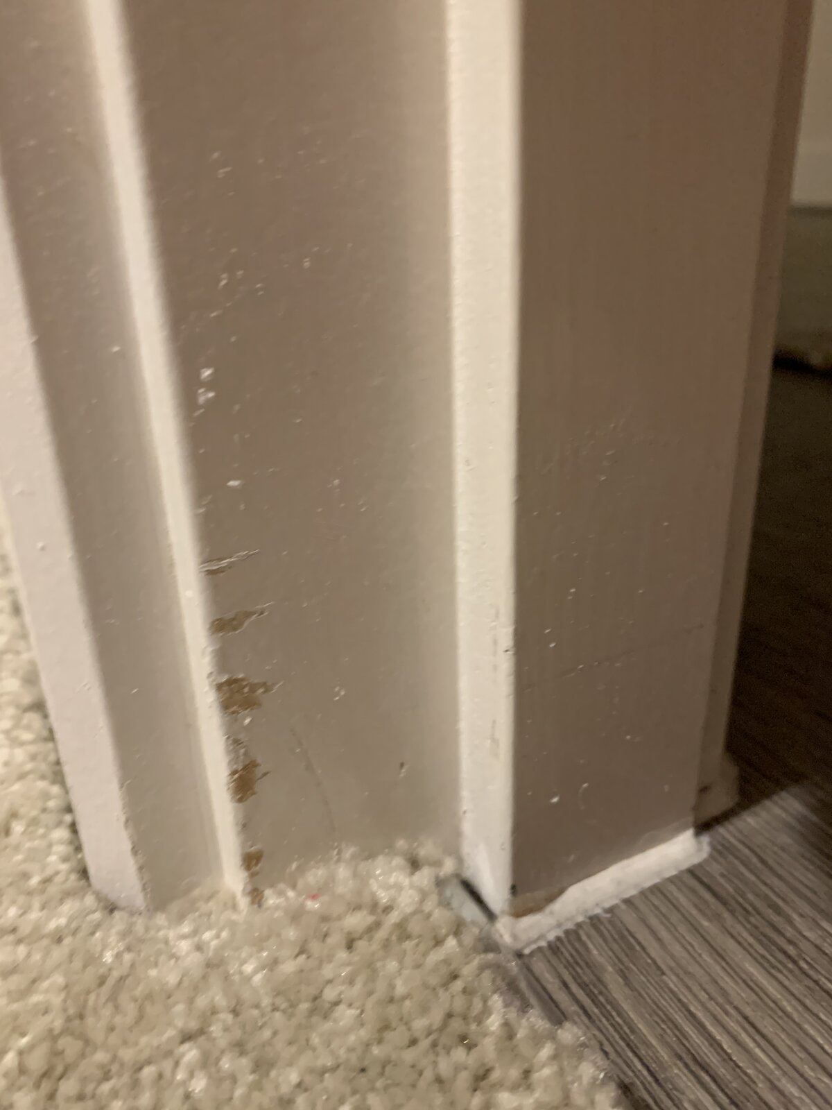

Hi, I was a bit heavy handed with the hoover and bashed it against the skirting board in that particular room. It has taken some paint off, you can see the wood underneath but there aren’t any chunks of wood missing. Would you sand with fine sandpaper? Then wipe clean and apply paint suitable for skirting boards? I have attached a photo. Thanks.

You'll get lots of that as the house is "lived in"
Rub it down Inthe affected area and paint some white gloss on it preferably the same paint as what was already on it.

As a professional decorator, I try to avoid waterbased finishes on woodwork. I don't like the way they flow and have found that areas that are often touched, the oils in our skin make the wb paints soft over time. WB does have the advantage of being less smelly, drying faster and not yellowing in dark rooms.
Anywho, regardless of which paint the OP decides to use, yes as you say they can feather out the dinks (to a degree) but they will need to apply a basecoat, eg waterbased primer/undercoat or even something like Zinsser BIN before applying gloss. without anykind of primer, the gloss will just soak in to the wood (much more than something like eggshell would).

I'd start with sanding the whole area as it's covered in bits and nibs.
It looks like water based satin is the finish there. What I would do is sand it over then apply an acrylic primer/undercoat. This is very quick drying and forms a much better bnd for the top coat of satin.
If you want to really protect from future knocks then do what Opps says above and use some zinsser bin before applying the top coats.
